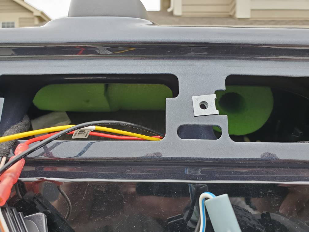

Just did a test on adding my idea to the rear headliner. It added more reduction to reducing the helicopter window down vacuum. Even at 80mph. More to come in that too as to where and how to get them "pinched in". First go around a couple vibrated loose.
Mega pool noodles aren't just for keeping people afloat. Three bucks at Wal-Mart and only a little bit is needed. I cut the remaining section in thirds for the better half for her boot support while in the closet ...haha.
Okay, maybe $6 as now I have to buy another one because 3 "boot" supports don't work for most.

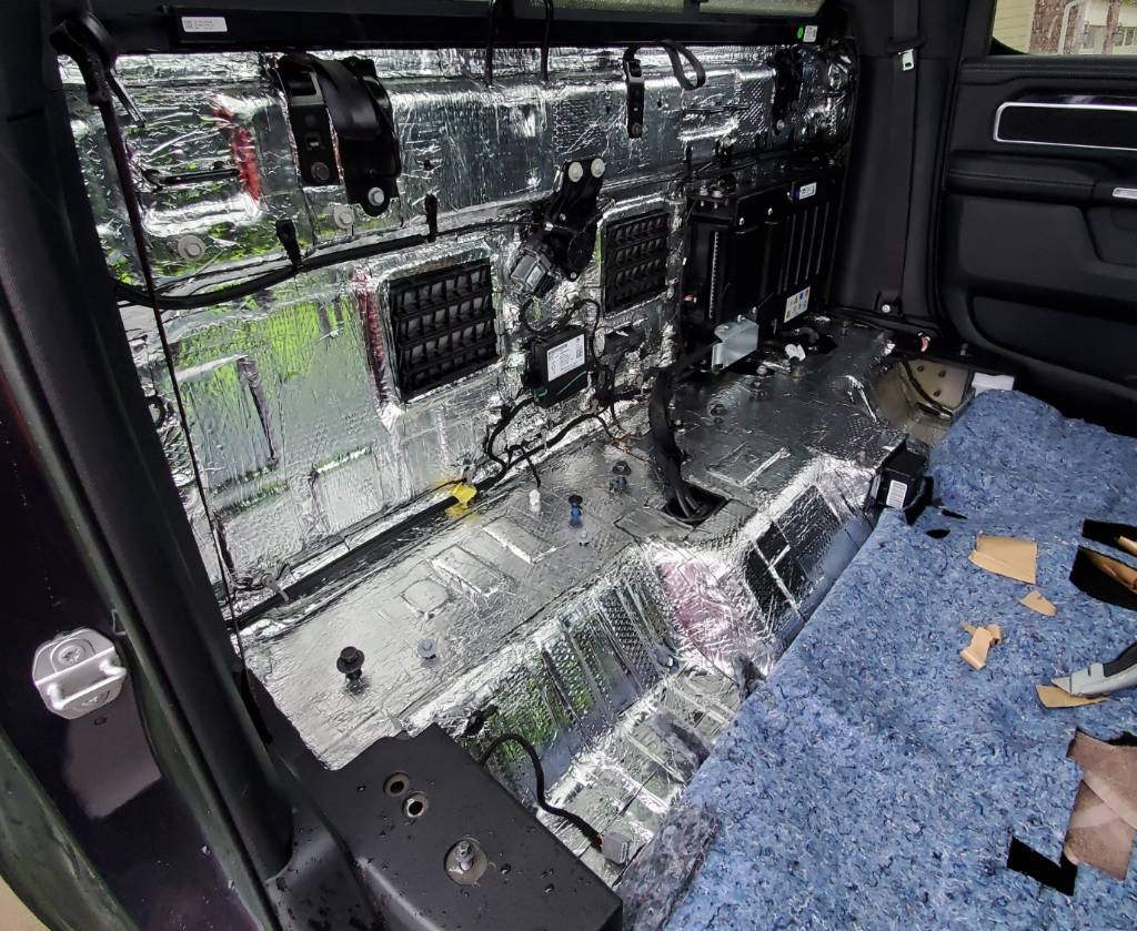

Sound material installed. Have enough left over to do the doors at a later time. My idea about vent covers didn't work out and need try something else.
I have the same stuff just haven't done anything with it but did you have the roller? Also did you just cut around the bolts, etc?
I did get the roller from them as well. It does make the bigger sections easier and for the cost, glad I did (heavier than most). My step son has used it since to roll on vinyl graphics to his shotgun case, so win-win.
I do recommend that when cutting the smaller pieces, as there are a lot, you discard the excess out of the truck. This stuff is so easy to work with and also recommend cutting the sections into thirds to work with. Very sticky and can grab on to the carpet. Hard to get out. I was "that" guy... Don't be "that" guy.
I put sections down at a time and if it covered a bolt hole, plastic mount support, etc...I would cut it out with a blade right after rolling it. Didn't want to forget to later...I however did cut out the wrong bolt hole for one of the seats. Put a new piece there and cut out the correct one. The passenger back seat rear bolt is not inline with the front. There is also a "knob" that the outer most portion of both seats have where it sits in one of the many holes that aren't used by the OEM. Not a problem as it can be pushed through the material when installing the seats. A lot of unused holes in the cab are covered by the material which helps.

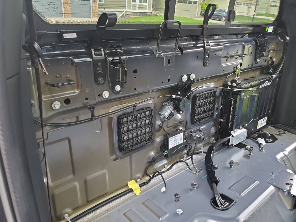

Took the back seats out and took it for a ride with me in the back to see what was happening.
Took two videos at different speeds and had my better half inable and disable the recirculating aspect if the climate system.
This is for sure the area where all the road noise is coming in for me and probably making it worse with the sub keeping the carpet away as well as letting it through the carpet cuts for the sub.
Going to seal off the sub and fabricate a cover for the vents as well as put sound material on the wall. The sound material will have little impact on road noise but I purchased it and will put it on anyway.
