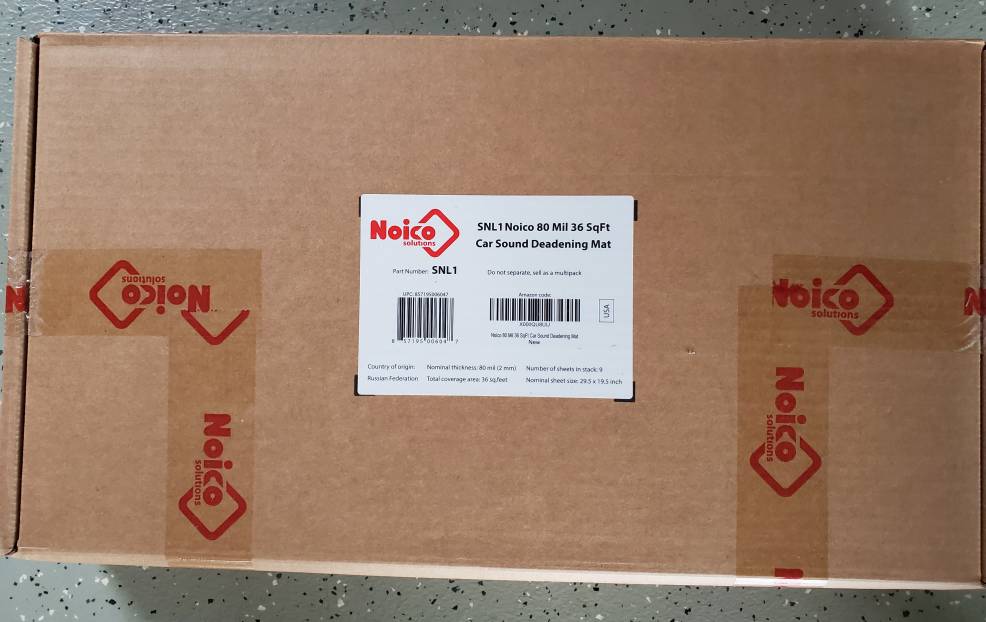

Sound material came in today and going to start taking back a part. Very heavy box.
Also doing the sub surround and vent covers. Here is the post I got the idea from

Took the back seats out and took it for a ride with me in the back to see what was happening.
Took two videos at different speeds and had my better half inable and disable the recirculating aspect if the climate system.
This is for sure the area where all the road noise is coming in for me and probably making it worse with the sub keeping the carpet away as well as letting it through the carpet cuts for the sub.
Going to seal off the sub and fabricate a cover for the vents as well as put sound material on the wall. The sound material will have little impact on road noise but I purchased it and will put it on anyway.
Video at 30-40 mph
Video at 75 mph
Will edit with progress

Sound material installed. Have enough left over to do the doors at a later time. My idea about vent covers didn't work out and need try something else.
Holy Cow... I have a quieter truck again!
An added bonus it feels like I added another sub! Will need to turn the bass down in the EQ... maybe
I'm wondering if the flaps in the vents get more pliable over time and open easier as time goes by. I don't remember my truck having so much road noise when I bought it. Feels new again!
Will put a write up together with pics probably tomorrow.
