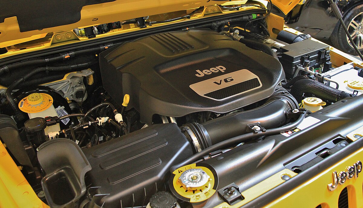

Which 3.6L Pentastar is it?
Good question and I'm not sure. Right now the current 3.6 puts out like 275hp ish ( roughly 205kw) power...I can't imagine them having a different engine from the one they currently use for the tradesman.
Without an alternator or etorque curious to know how much power the 3.6 puts out. Ramcharger is listed as 130kw power generator...but it's a decent difference.
