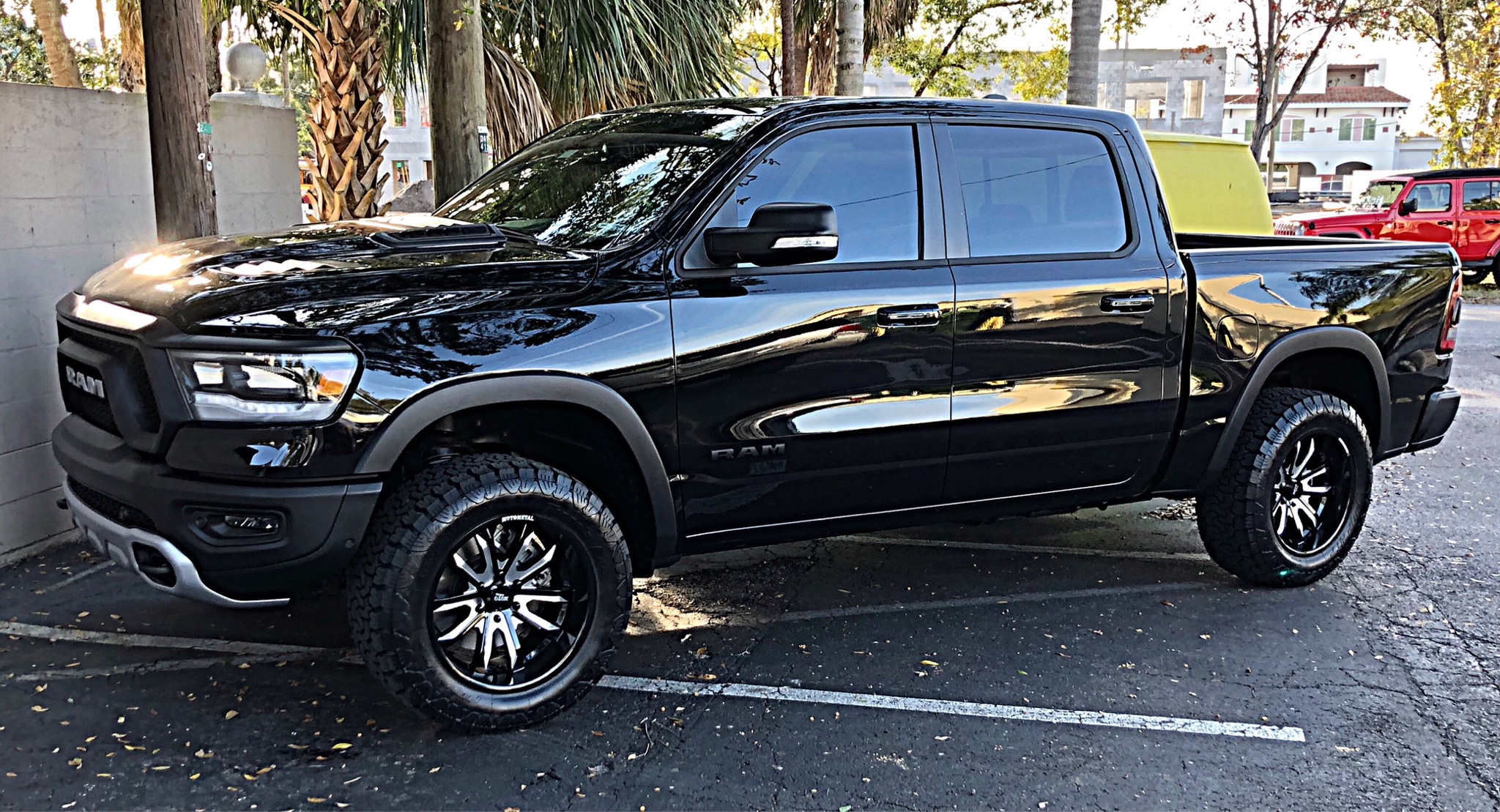

Just finished up the 2” Readylift leveling kit with the upper control arms. #66-1921. Took me 1.5 hours to do so not bad at all. Front measures 40” from ground to top of wheel arch and 40.5” in the rear. Goes in to the dealer for new rims and tires on Thursday.
What size rims and tires can you get on with the 2” kit?
