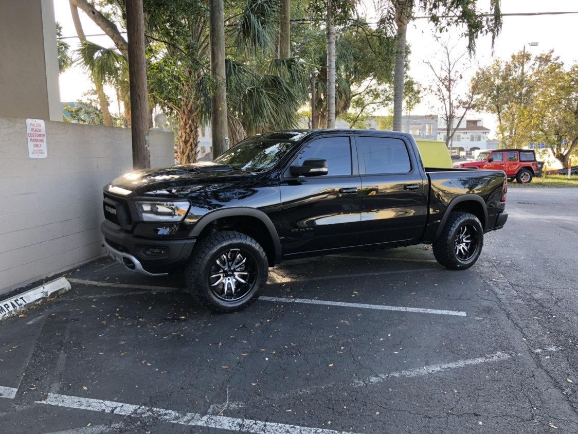

Ready lift 66-1921
Moto Daggers 20x10 w -18 offset
305/55/20 Goodyear’s
