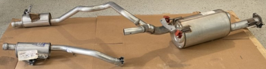

The cabin sounds fine it's not obnoxious at all. Yes it sounds throatier than the standard DT Hemi and worth it.
The muffler and drivers side resonator are connected as 1 long piece.
The passenger side resonator is on a separate pipe that slips into the Y after the muffler.
My 2023 Laramie Sport came with G/T resonators so I needed the muffler and drivers side resonator assembly part # 68517364AA.
The G/T Left Resonator has this number stamped on it C-9408-L the right C-9408-R the G/T muffler is stamped C-9396.
