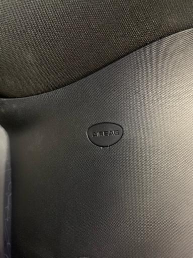

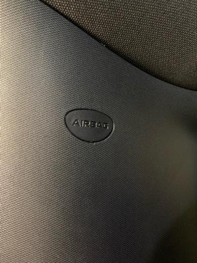

Does the c-pillar plastic trim have to be removed when they replace our back windows?
Mine was replaced a few months back and I noticed the screw access holes has some pry marks on them (not from me). I’m guessing this is from when they removed them to resolve my window.
I’m the only owner of this truck so if it wasn’t me, by process of elimination...
