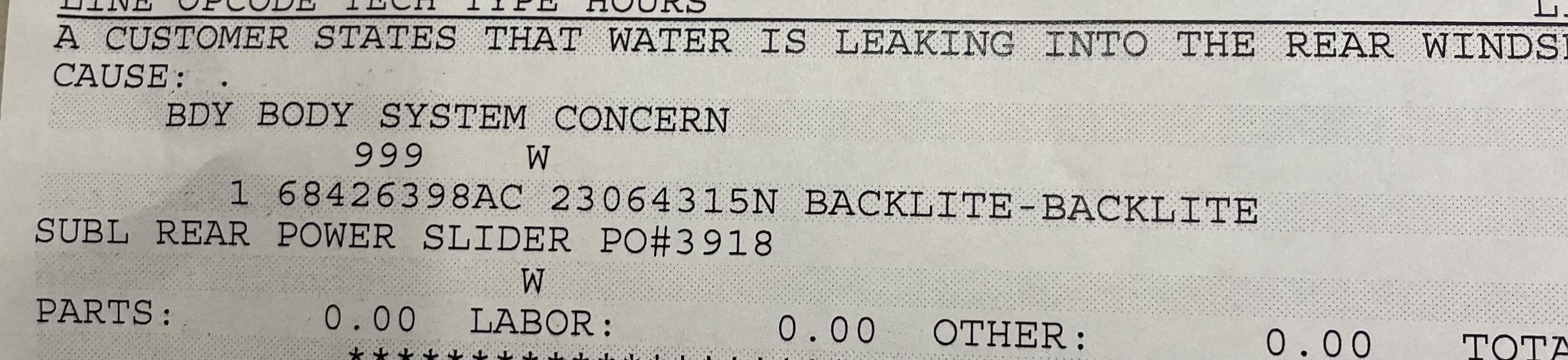

Is this window the new part # ?
From what I’ve seen on here so far, it’s not the newest revision (still the AC p/n)

I remember reading tha as well. Mine was replaced with the same part number (AC). I asked for the "new" part number and they said that was it.
Could the dealership be mistaken? Yep. Could a user on a forum be mistaken? Yep. Could information posted a year ago not be relevant any more? Yep.
Regardless of who's right or what the right answer is my 'AC' window replacement has been holding up well since it was replaced almost a year ago (June 2020).
RAMcares informed me that inventory of the "old" windows was purged in November 2020, so any windows being sent to the dealerships for repair are from the latest and greatest supply. I guess time will tell if the issue has been resolved, but it's good to hear your repair has lasted 9 months without issue.
