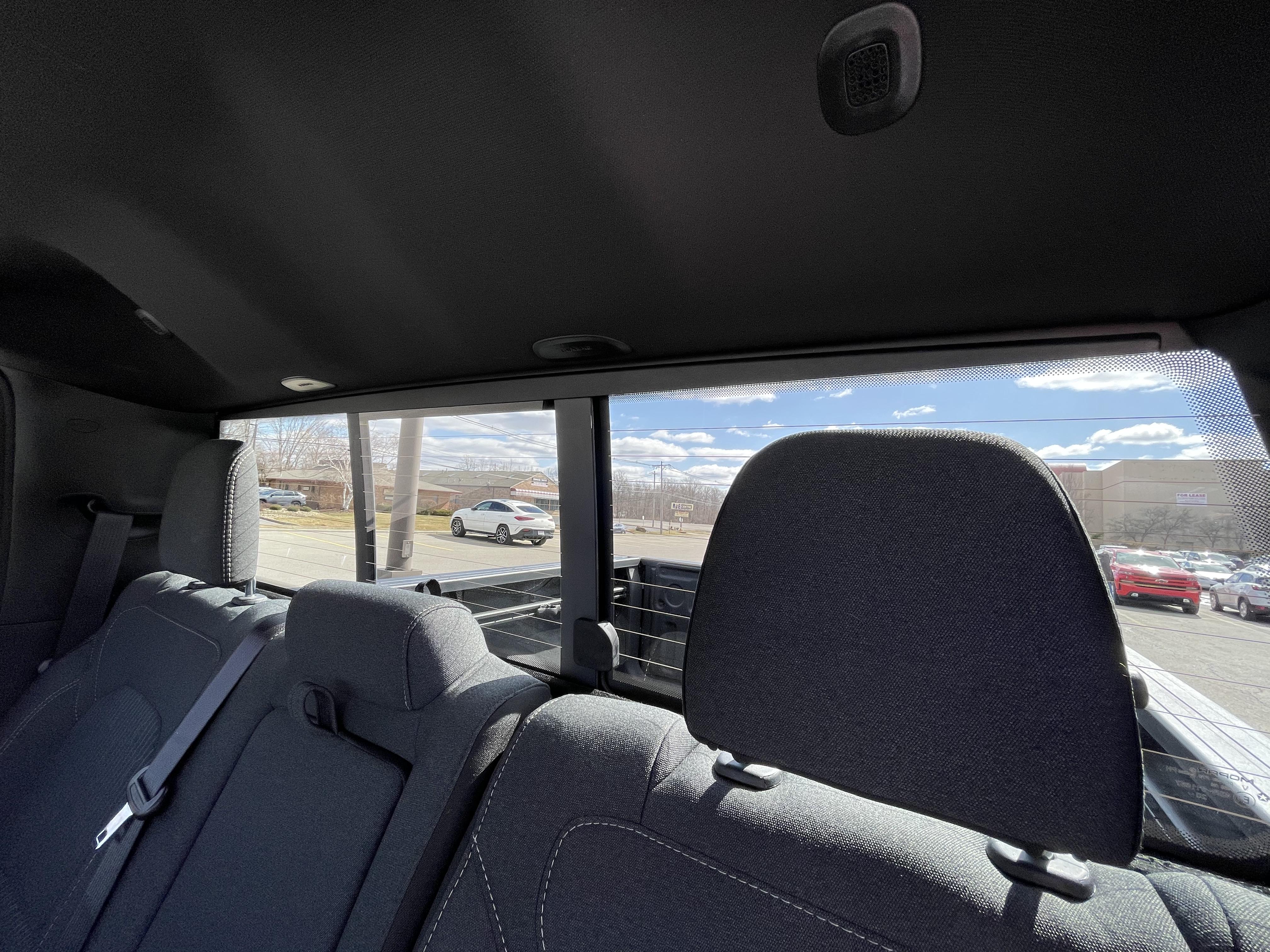

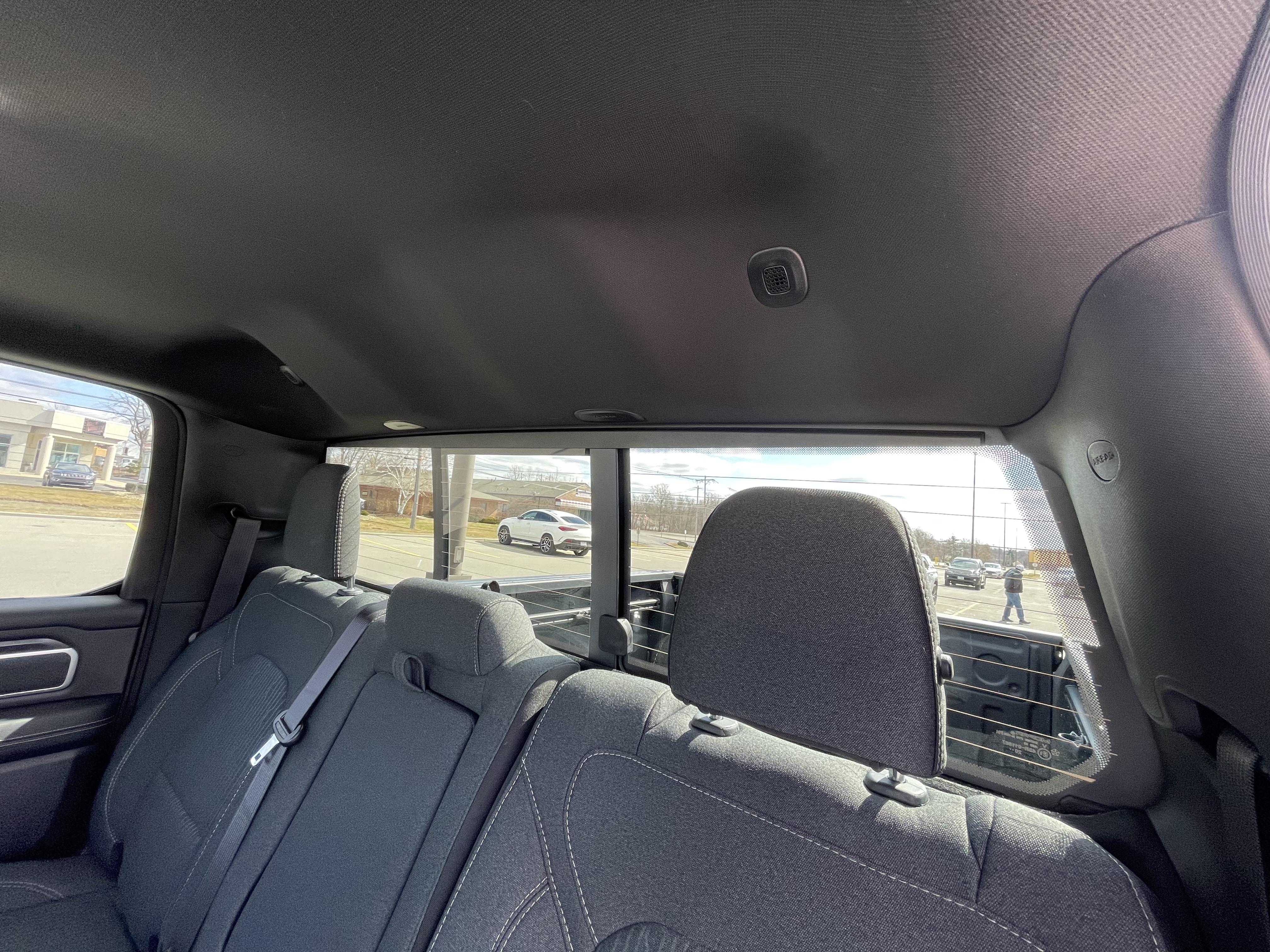

mines been in the dealer since the monday after the superbowl! 02.09.21 had to wait for approval .. its still there... waiting for window and frame to come in, loaner 2021 Ram has the water leak as well 1300miles on it, also replaced 3rd brake light that came with torque screws. still waiting patiently...
Picking mine up tomorrow after the replacement window was leaking a week after it was installed.
They needed to reseal it ...this should be an interesting conversation
just talked to the Dealer window and frame due to arrive march 25th, thats correct march 25th, advised him thats almost 2months, also advised them the rear window in the 2021 loaner is leaking also, taking the nice guy approach so far, i got 4 new tires in my basement im going to ask them to mount for the inconvience tmrw my serv advisor wasnt there today...tryin to keep calm..

Can you tell if there is anything different about It? Doesn't look like they switched to a metal.
