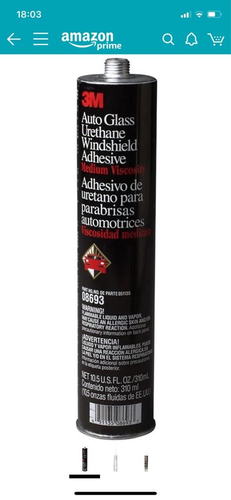

Actually the best stuff to use would be the butyl sealant glass shops use when installing windshields! Just dawned on me.
