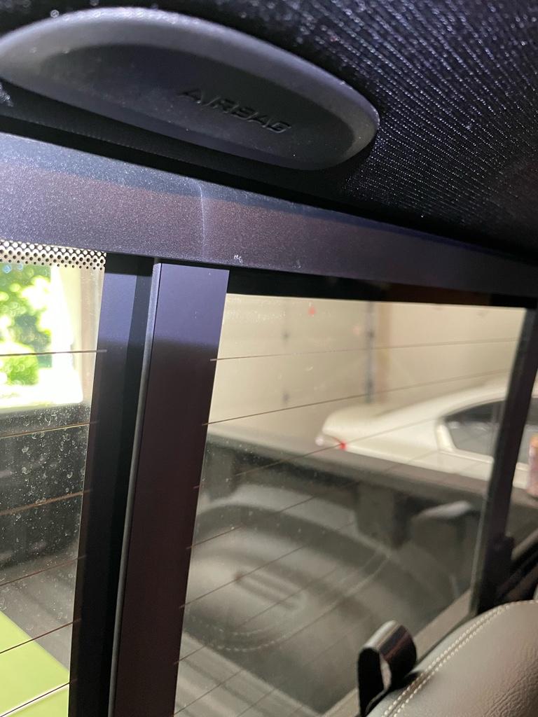

I had my rear window replaced under warranty last year (5/4/21). It had the crack in the plastic on the passenger side of the sliding window. Fast forward a year... I noticed the new window started to leak on the same side (no crack this time), with water running down the passenger side window panel. I now have another new rear window (6/8/22), replaced under warranty as the first replacement was a "failed part".

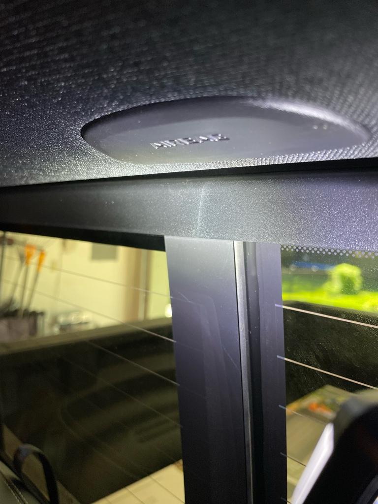

Just noticed mine has 2 small cracks on either side of the sliding window lucky no water leak yet.

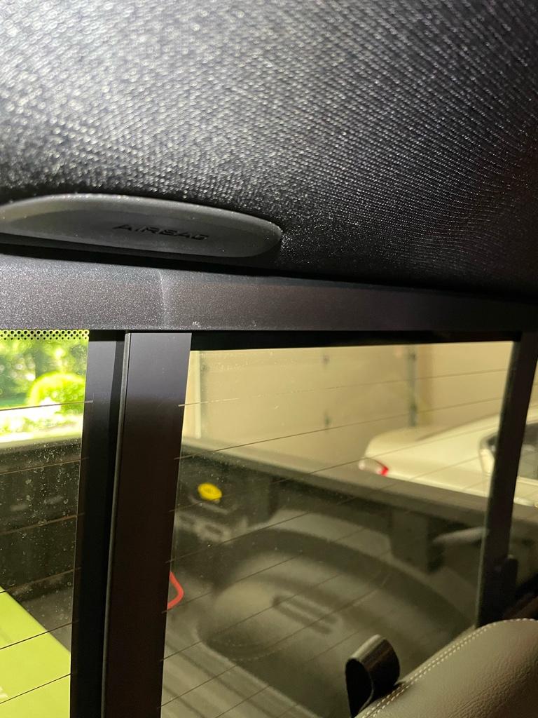

Hey guys new here. Noticed this on my “new” used 2020 today. What do you think? Still under my 3/36k factory warranty.

Not that I have seen. @RamCares do you know?
Someone on this forum posted that the problem was the original sealant used around the rear window got too hard over time and would not allow the rear window & frame to flex and this caused the frame to crack; the factory switched over to a different sealer that remains flexible and will not cause cracks.
Interesting. Thanks for information. We will see what the dealer says on Monday.

I just discovered I have 2 cracks in my 2019 bighorn. Called the dealership and they informed me I am out of my factory warranty despite only having 27000 miles. Ram cares can you help?
Are you past the 3 year mark? @RamCares
