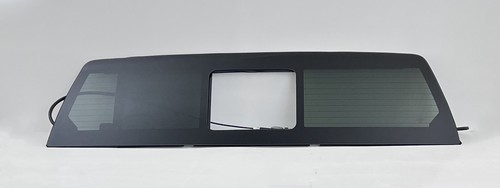

The below post on Facebook shows an aftermarket window option. I don't know anything about but I haven't seen it posted here yet and thought I'd share. I have a very minor leak on the passenger side and it's going to the dealer later this month since It's still under warranty.
Edit: added a picture for the peoples not on the book of faces.
https://m.facebook.com/groups/132712600919099/permalink/1365789930944687/?mibextid=wIhsxK
Nothing comes up in a Google search for "aftermarket rear window for Ram 1500" or "F150 style rear window for Ram 1500". Whoever is making these is doing a poor job advertising it. I suppose it might be a prototype.
Edit: I found this one on eBay for the 4th Gen trucks. Does anyone know if the rear windows on the 4th Gen's fit a 5th Gen? I sent the seller a message, asking if they plan to make a rear window for the 5th Gen trucks.
