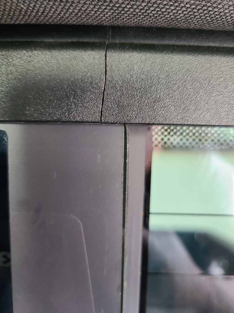

I purchased a 2019 Ram 1500 used last year with 13k miles. It has been garaged kept so I didn't notice the leak until I had to park outside when we put my son's furniture in the garage. I now have 15k miles on it. Took it to my dealer today and they showed me the cracks in the rear window frame right away. Since it was sold new in October 2018, it is out of warranty. Is there anything RamCares can do to assist with getting this replaced under warranty?

Mine had the same issue. Out of warranty by 7000 miles but Ram covered the replacement. It is a known issue
Just got both manifolds covered under warranty on my 19 1500. And this morning I noticed the rear slider has the infamous crack, with headliner stains. I am still in warrany so finders crossed.

The part was broken prior to me parking it in my driveway. In other words, under 36 months, under 36k miles. If you read the bumper to bumper 36k mile 36 month "limited" warranty I'm not sure this is ever covered. It might be under the 12 months on gaskets and seals. But this is a plastic frame. And its definitely not covered under any extended warranty. Yet, this has been taken care of for thousands of people. Even second owners. And many owners with more miles then I have (40k and 50k from what I have seen). There is a TSB (23-016-21) and there is a Star publication on the problem. Actually, two of them (S2023000024 and S2023000005 Rev A). FCAs reputation (and maybe fear of a class action?) mean something to them. This is a defect in 2019, 2020, and early 2021 (prior to the new part design, new part numbers, making it out) DT models. There are examples of this exact issue in trucks that had less then 5k miles on them. Check the forums, check the Facebook groups.

I just got my 2019 1500 Limited 29 months/41k miles, back from the dealer here in GA, who was replacing my dash. I had them look at the rear window as I noticed it leaking a couple of days before when we had a little rain. They verified that it was cracked, at least the interior trim piece, and that the window and 3rd breaklight needed to be replaced, all at my cost, $2100. Even with my Maxi Care extended warranty. Like everyone else...glass is only covered in the first 36k/36 month window. Some of the parts are on backorder too. I've reach out to RamCares so I hope to hear back from them soon as we are getting into the rainy season...like last night. Plastic bag over the light did the trick over night so I was dry this morning.

You can buy the 3rd brake light online for less than $50 and install it yourself, very easy. You can also leak test the car yourself and see if the brake light is even leaking. Dealer may have just recommended it as it is a common leak point.
Be aware the screws are also changed and how tight or not to make the screws. I chose to be proactive versus a potential headache and dealer visit.
