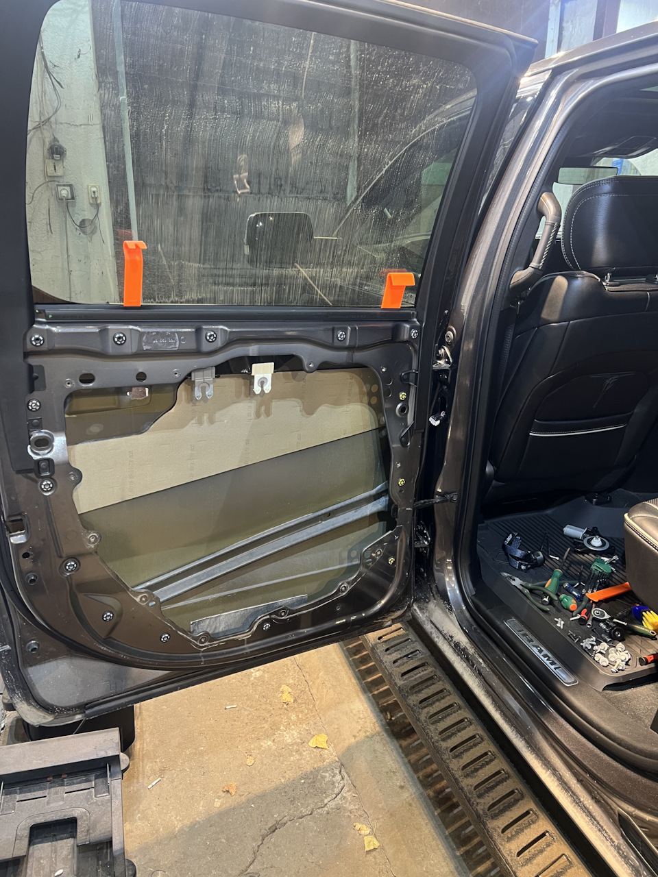

I had enough with this and started to dig in myself. Dealers here in Omaha, NE should they are like 2 weeks backed up or something like that. Anyways like I said in my post above, never experience this issue until I moved to NE.
So after watching number of videos and blah blah blah. I found this guy that was installing the passive entry, thank you, whoever you are and sorry for copying your video
Yes, you do need to remove the entire inter panel and disconnect the window. It is pretty easy and do not force anything. My door latch that was freezing was only my passenger rear. All the other doors were fine.
His instructions are pretty much the same for the rear doors. Just I did not disconnect the wiring harness to remove the panel totally out of the door. So my problem wasn't the cable freezing. It was what the cable was attached to inside the latch itself.
I lubed, freeze proof grease, WD40, Waterproof WD40/Silone, everything into the blue circle areas on the latch. (do not put lube in the blue circles in the pictures where the bolts go into btw)
On the latch itself it has a black cover. Just pop it off. You can see the cable where it is attached too. That linkage was stiff, after lubing it and actuating it a few times it loosen up.
thumbnail_IMG_2105.jpgthumbnail_IMG_2105.jpgthumbnail_IMG_2106.jpg Just reserve order the process and make sure you recheck the black cover again. Because I forgot to do it and now need to reopen everything again... arrrrggg.. So tonight/tomorrow it suppose to drop temps again. So hopefully this worked.
View attachment 196212View attachment 196212View attachment 196213 Just reserve order the process and make sure you recheck the black cover again. Because I forgot to do it and now need to reopen everything again... arrrrggg.. So tonight/tomorrow it suppose to drop temps again. So hopefully this worked.

Damn..... so yours froze again after greasing and all that? I also noticed that if open from the inside it latches just fine.
Yep, unfortunately it did. And i also noticed the same…that opening from the inside it works fine. The child lock just builds the habbit for my youngest to get in/out the other side. I actually haven’t checked if its working in a couple weeks..im hoping to keep it out of my mind until the spring and hope it works regularly then. The whole sex panther probability isn’t something I want to mess with when its cold.
Also hoping a tsb or something comes out by then.
ahhhh crap.... did you replace the cable? or anything else? Looks like replacing the cable is pretty easy compare to replacing the latch mechanism. I'll repost tomorrow morning ish.
Yup... didnt work.... time to replace the damn cable.
