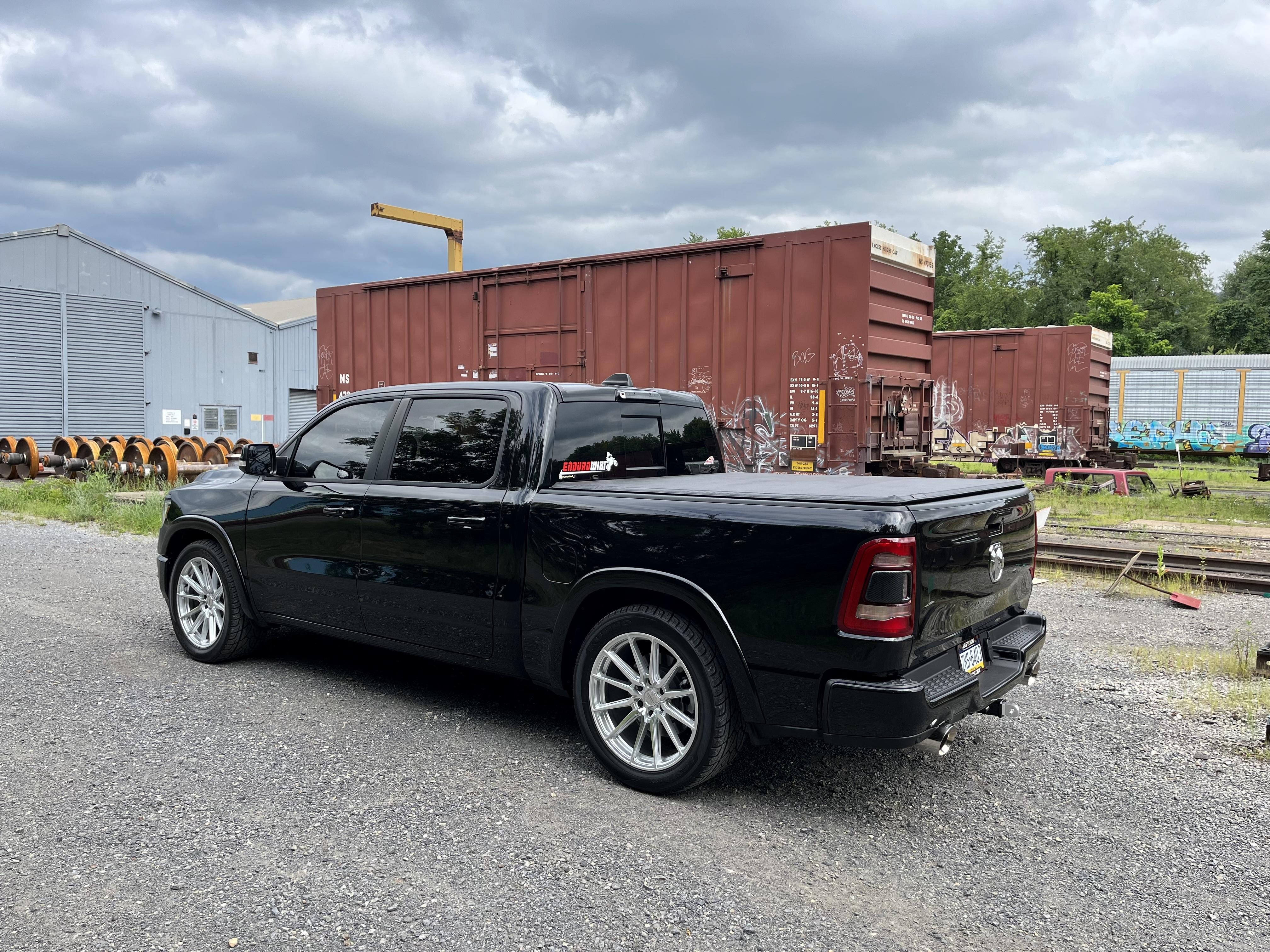

Post your lowered 5th gens
Like the title says. I want to see everyone’s lowered 5th gens.
Post a picture and a description of your setup!
Maxtrac 2/4
Bilstein 5100 rear shocks
Spohn adjustable panhard bar
Hellwig sway bar and end links
Core 4x4 rear lower control arms

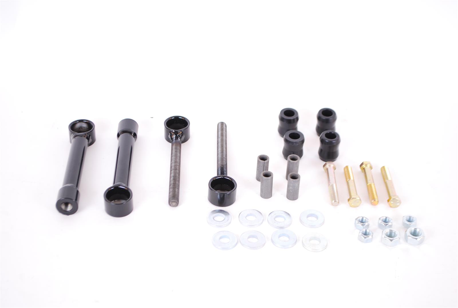

What rear swaybar end links are you running? If Helwig do you have the part number?

How are you alignment specs when it’s low?
Not sure, feels straight when driving. Today, the truck only has 1,000 miles! Haven’t needed to touched the suspension besides adding the revel links and cutting out the bump stops. On Monday, I’m gonna follow your advise and I’m gonna pull the trigger on some new rear shocks. I’m going with QA1 TD902’s and see if that helps lower the rear inline with the front. At that point, I’ll obviously get a alignment. I’ll snap a pic of the screen when completed.
