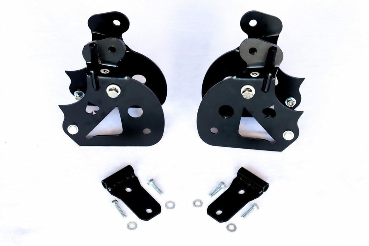

The issues come into play with suspension travel, even with our 4" rear drop it is close back there. I have a few plans just to see what can be done to remedy that without the cut kit.
But if it does come down to me needing it it's an easy mod.
They told me the control arms will hit stuff going lower
And its a real possibility that the arms may hit without the cut kit. I know the first thing they will hit is the cup that holds the bumpstop.
The 4th gens had a no cut relocation bracket, it would be nice if someone came out with one for the 5th gens!

Going any lower than 4 inches requires a cut bracket.

This isn't necessary for the 2/4?

Nope, not needed on the 2/4.
I will say I've been real tempted to cut the bumpstop cups off as even on my 2/4 I've smacked them a couple times.
