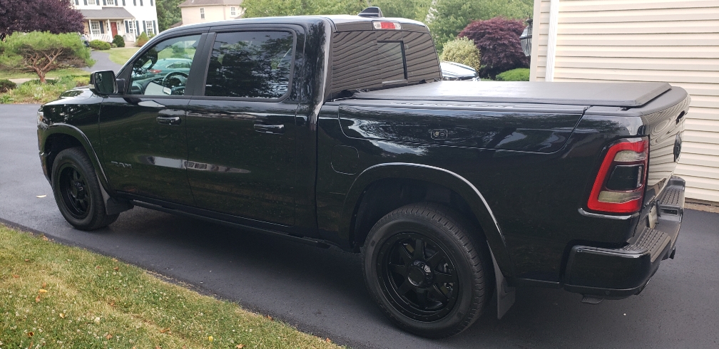

Here's my 1061lbs Limited now 80lbs lighter thanks to new lightweight alloy wheels and better highway towing tires.

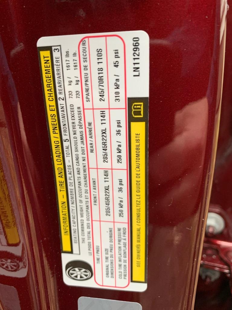

To give you guys looking for a Longhorn something of a baseline, the only additional options I wanted and bought were the 3.92 gears and anti-spin on a 4x4, crew cab with 5.7 bed as shown in my signature. My payload per the sticker is 1572 lbs. I think that’s about as good as you can expect in a Longhorn.

You’ve got more than 500 lb payload advantage on me!
Any other options? That’s a really good number for a 3.21
