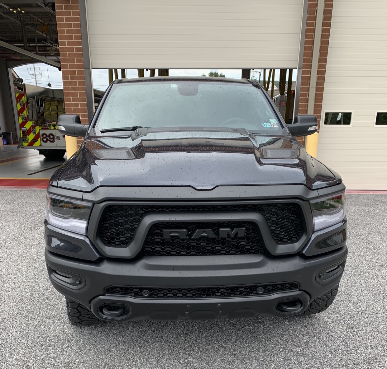

Painting front skid plate
They don’t send out the pointy stars in the picture anymore. They sent me the rounded ones, and only after emailing did they send the sharp ones. May want to email them in advance.
The grey stripes (and stars) are just the exposed primer. I masked everything with masking tape.
Thank you!
The flag is super cool, just trying to think of way you could make that more permanent? Seems challenging if you really want it to look good. Maybe spray linex and immediately pull the masking and stencils or what not and hope it doesn’t distort
Not sure on the best bet to making it more permanent. Bead-blasting the factory finish could make the paint adhere better, but that would require removing the plate, having access to bead-blasting equipment, and worrying about rust.
Line-X is textured, so getting the star pattern sharp would probably not possible for anyone without expensive, specialized equipment that may or may not exist. I also looked into getting the plate line-Xed, but the shop who did my bed said they couldn't do the plate for some reason, and recommended I powder-coat it. Powder-coat places around here all estimate lengthy turnaround times, and I didn't want it done badly enough to deal with poor business models. I called four of them, and not one would allow an appointment in advance; just drop off and pick up in a couple weeks.
