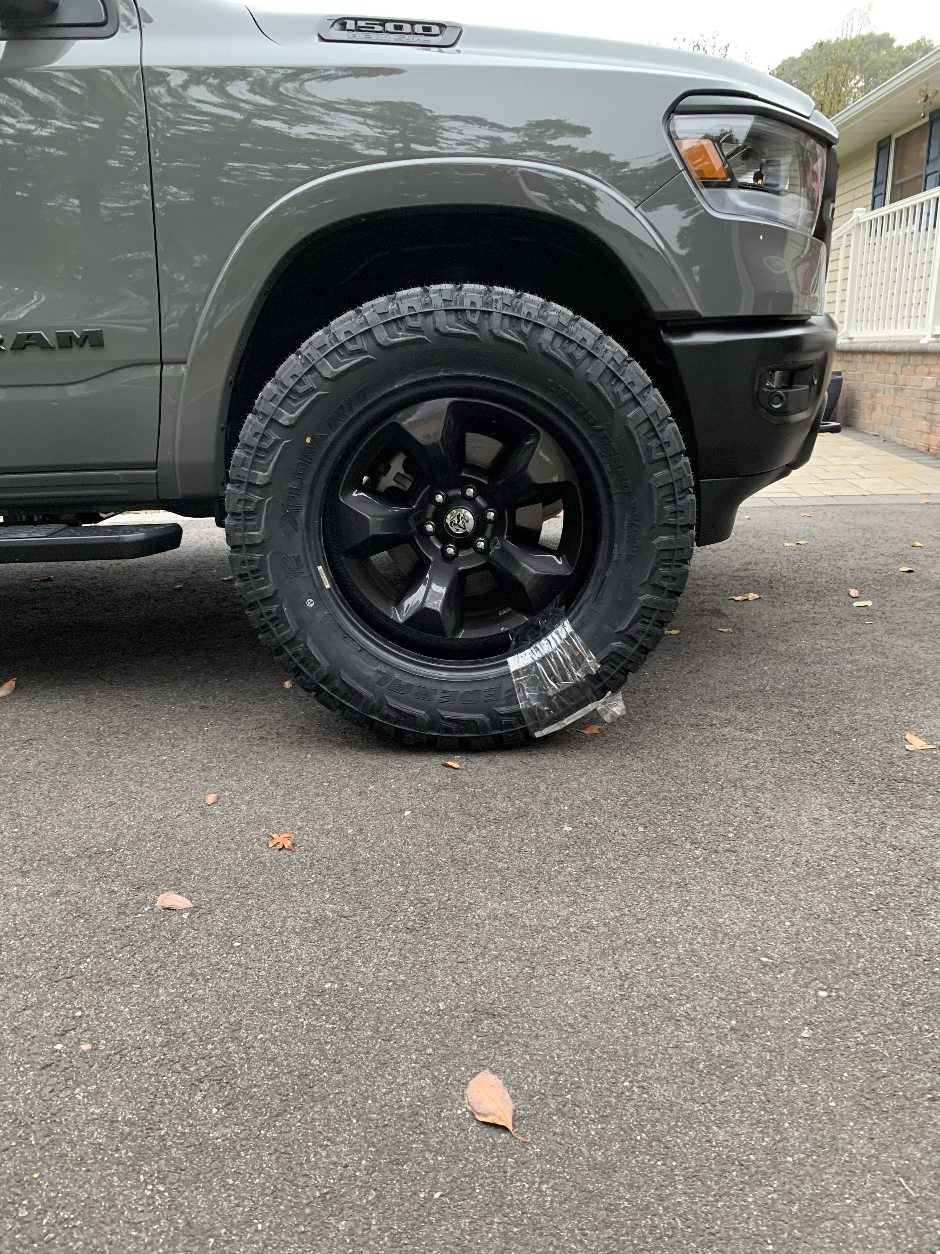

I saw that one, I meant to say a side shot of your truck with the 275/65 in front of your stock setup, Im trying to gauge how much more it fills up your wheel well
Here you go
Here you go
Thanks, the 275/65s certainly fill up the wheel well much better than the stock 55s and they dont look too obnoxious
Finally completed!!
Truck looks badass! How does it ride compared to stock?
I'm doing pretty much the same setup minus the wheels. Keeping Laramie stock 20"s with 295/60 Wildpeak AT's
Honestly,
The ride is damn near identical,
The only difference in ride i attest to the Nitto Ridgegrapplers, being as they are more aggressive than the OEMs. im very happy with how it turned out,
