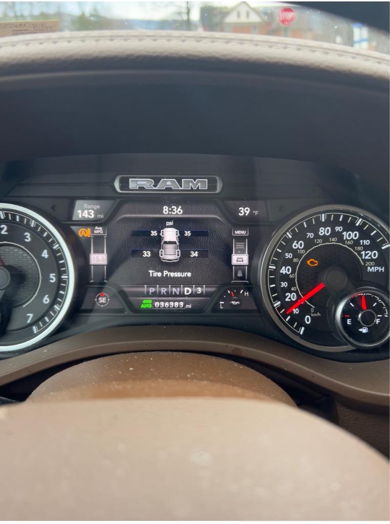

And ram has issues with their DOD/AFM also. My buddies 21 ram is in the shop now for it with 30k on the clock.

You mean it's only running on 4 cylinders full time, or the eco light is stuck on? Being stuck on 4 cylinders would suck big ones.
Yeah won’t leave 4cyl

What kind of issues is your buddy having with the MDS on his '21 Ram? Even though I dislike having it, and there are lots of complaints here about having it, there haven't been many complaints here about the system having issues.
So he got the truck back. They said it was a solenoid. They replaced it, he went home. The next day going to work it happened again so it got towed back to the dealer.

Anyway, my buddy got his truck back, they said it was a stuck solenoid. He drove it for an hr and it happened again. So it’s back at the dealer again.

And my buddy is currently experiencing an issue with the mds system at 36k
Update on this. They had his truck for a week. Still can’t pinpoint the issue. So they are Buying it back and he is getting a gladiator tomorrow.
Unfortunately we won’t have a ending to this.
Apparently they even had a special tech come in and try and fix it. But it’s intermittent when it stays locked in v4 mode.
