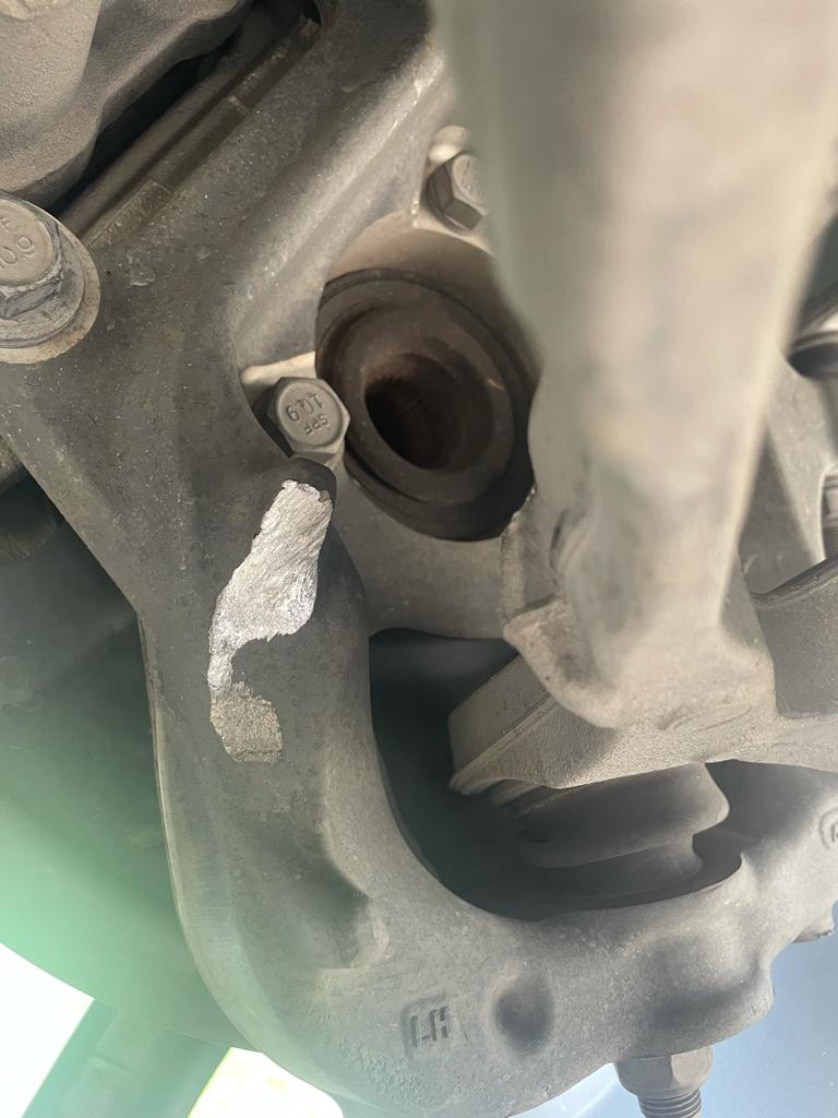

I have the RL 3.5” kit. Running 35x11.5R22 Nitto Ridge Grapplers. Everything fits great and has the stance and look I was after. Problem is the wheel hub/knuckle makes contact with the Lower Control Arm. And by contact I mean that it has cut into the metal in full turn aka trying to park. Had the shop call Readift and they said they knew about this issue and we should just grind down the points of contact. The other issue is that with 35’s it seems to be exceeding the maximum span of the OE parts. Because there is a very noticeable negative camber. I am working with another custom shop now to see how to correct this. Is anyone else having this issue?
