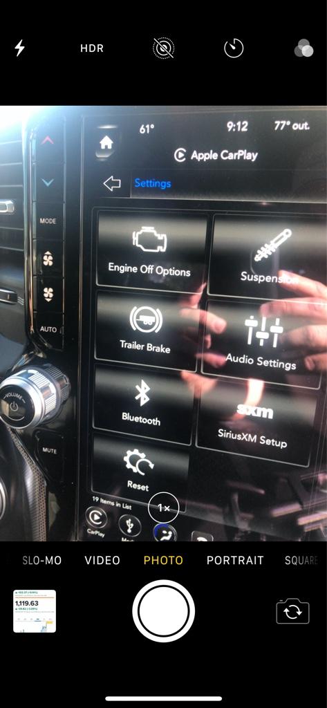

There’s a reset button buried with in the apps menu. Have you tried that?

@LimitedGRR I was not aware of a reset button. Do you happen to know where it is at in settings?
If you go into apps the settings and scroll down you’ll find it...

There is no reset on the 8.4 screen thats only on the 12".
