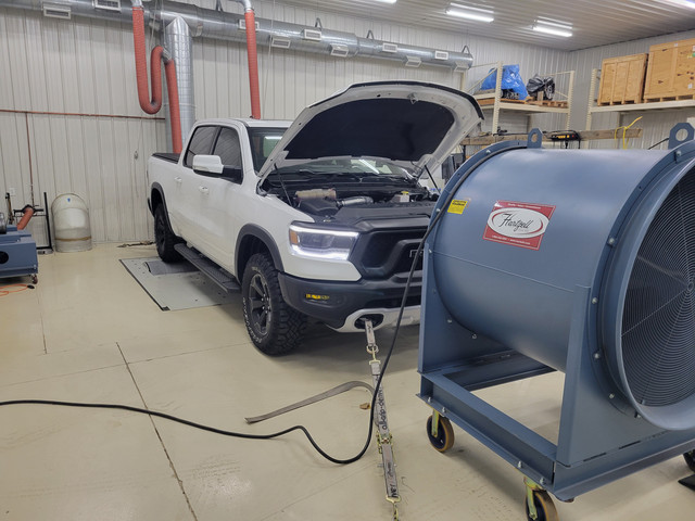

Is this your truck @Daverous ?
2020 1500 Rebel 3.0 Ecodiesel, 3.92, 12A, Level 2, Ramboxes, 33 gallon tank, 50k miles
