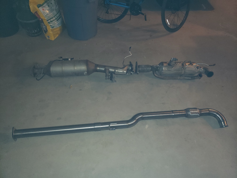

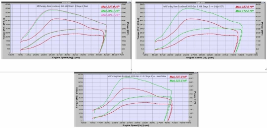

DieselRebel, did they send something to plug the return cool egr pipe? I guess you just tape up the wires that were connected to the old pipe? Dang... I wish there would be some type of dyno or comparison to this tune to the soon to be released GDE. Is there a dyno chart of the MR Tuning Stage 2? Do you get much smoke from your tune?
Yes, I installed a block off plate.
Here is pic of stage 2 dyno charts from his Facebook page.

so you gain 100 hp ? cnt see lol my eyes are sucky
