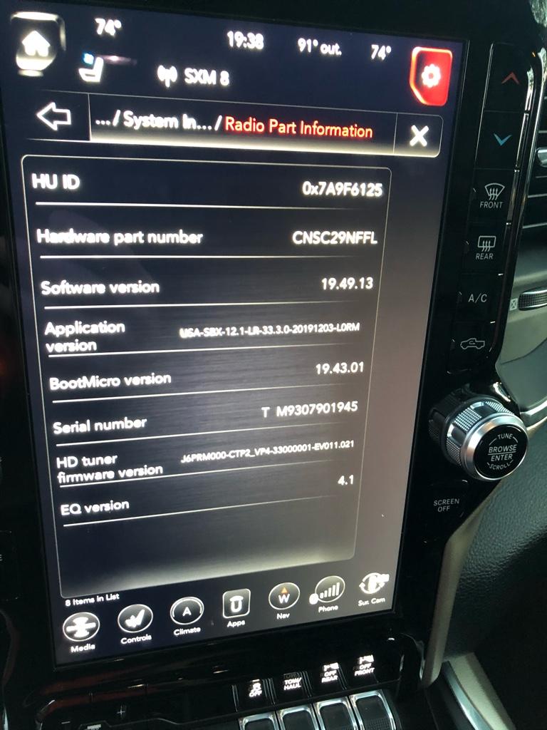

Evening, so I will openly admit I read a few pages and got pulled away at work before I could google it. Yes, I will be lazy , its been a long day. How do I find the SW rev on my radio? I assume I have to get into the engineering menu somehow??
At the bottom of the screen, press the button on the far left and far right at the same time. Doesnt matter what screen you are on.
Good Morning all! Just purchased my 2020 Limited yesterday and it prompted for an update when I pulled into the garage. Hit update, and walked inside thinking "cool, no big deal" Then I did some reading last night (found this thread) and was ****ting myself thinking it was going to be bricked when I checked on it this morning. Well, initially all looks well. Will see when/if I leave the house today. Here is the info from it...

Congratulation on the new truck, i know you love it right now and hope unit enjoy it. Glad to hear you got an update but FYI that is not the latest one yet, the latest version is 19.49.13 but it better than nothing, many peoples still using alot older version than you.

I believe that 19.43.1a is the latest firmware for the 29N3 hardware, which is the latest released (2020) hardware version we are aware of. Earlier version of the hardware (2019 & 2018) got a different version of the firmware with what appears to be a later version number, however we have no idea if 19.43.13 is newer (with additional updates, features, etc.) than 19.43.1a, has less or is somewhere in between. Hardware and firmware version numbers (and capabilities) have to match up to each other, so a 29N3 hardware will never get a 19.43.13 firmware, at least that is how I believe it works. It is also possible that the .1a is actually a later number than .13, we have no way of knowing their numbering system. It could go .11, .12, .13, ..., .1a, .1b, ... etc.

What you said is possible but if you look at the software build date, the 19.43.13 is in December and 19.43.1a is October.

I do not believe when a build is dated or released has anything to do with it in the short term. A group of releases for a group of hardware versions each has their own timetable during development and testing. Only FCA/Uconnect has the master list for all of this, we mere owners can only take an educated guess.
