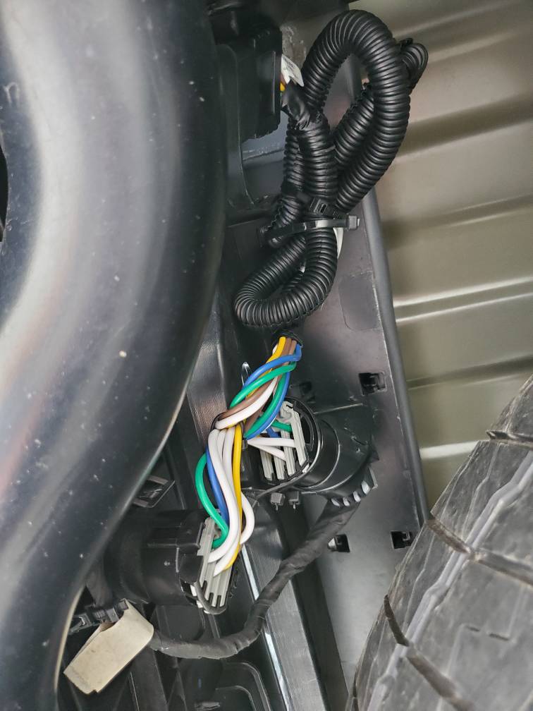

Done with the install. Quick and easy.
Would have taken 15 min, but I wanted everything nice and tidy, so it took about 45 min from start to finish.
Blue cable goes with the LPRs dashed cable (positive).

Install Detail:
Trailer connector is not hard at all to remove. Just grab it and pull back towards spare tire.
Once everything's connected, I wrapped all connections with electrical tape to seal against moisture.
