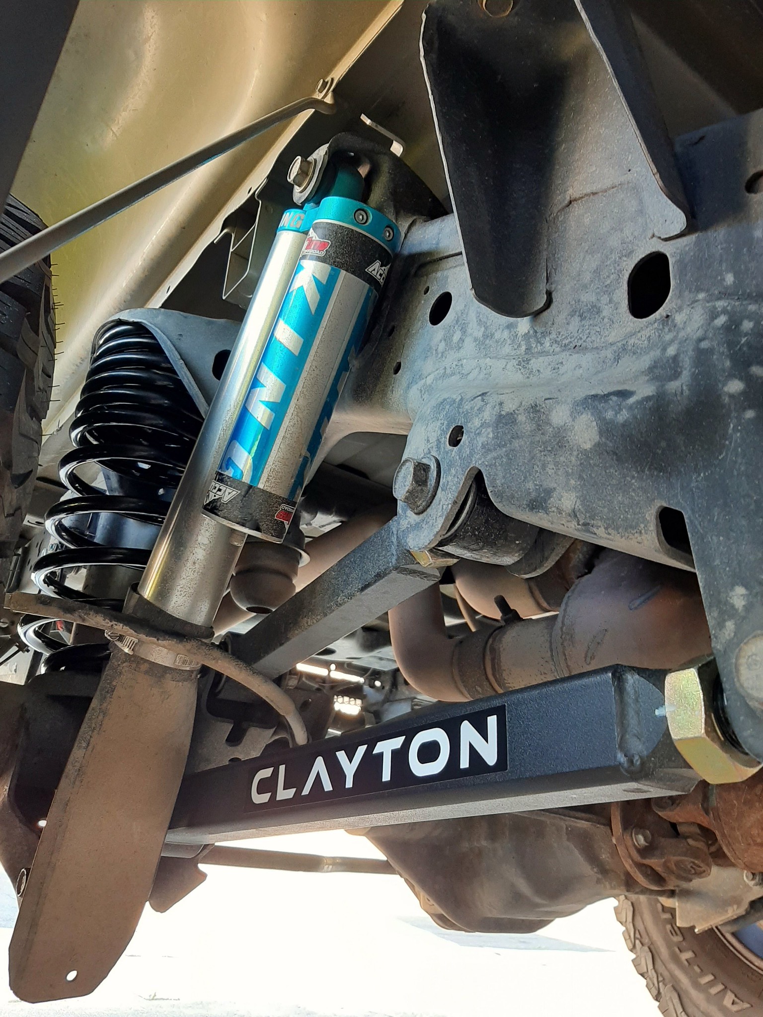

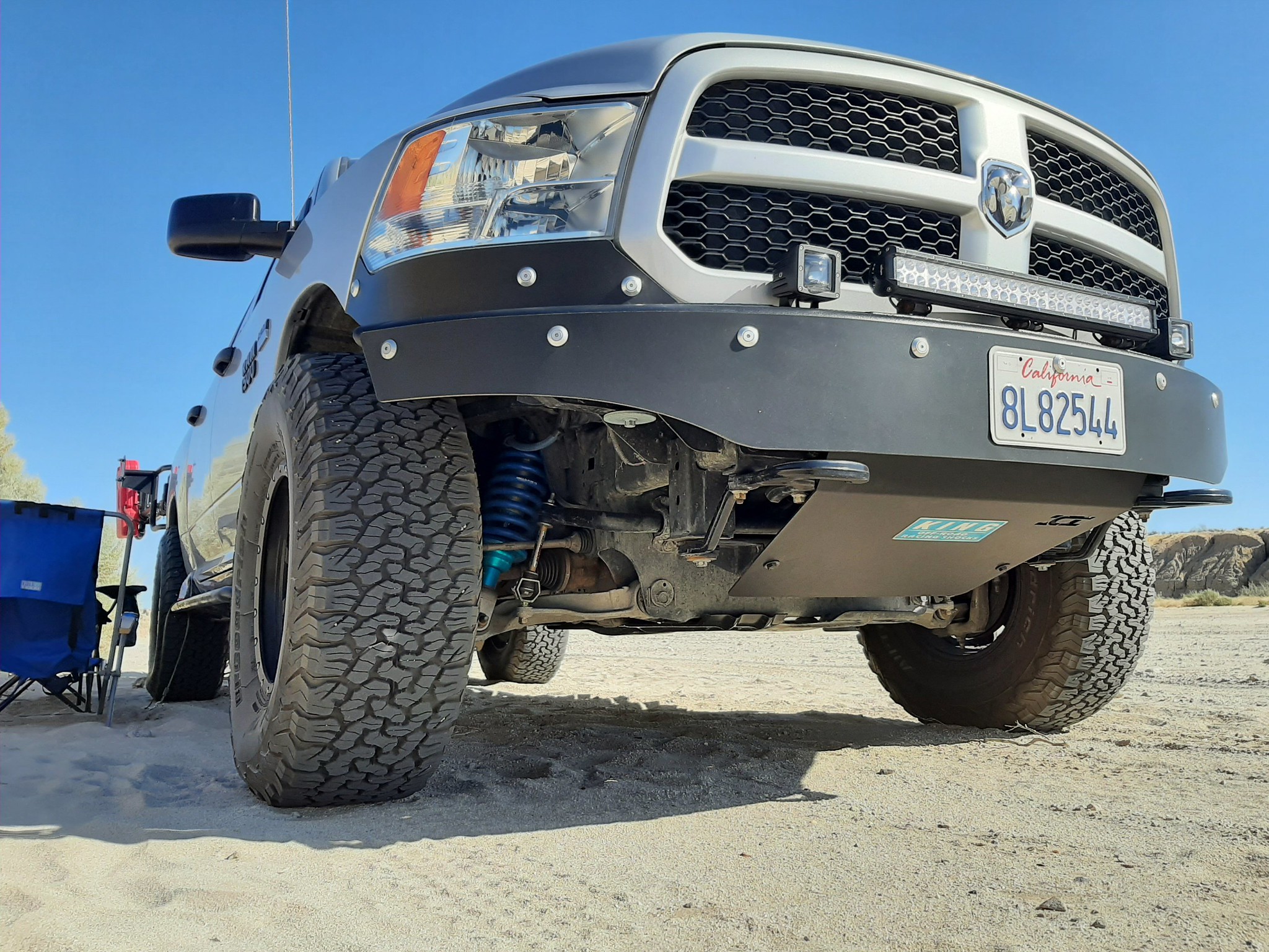

wow thanks for the info. best post yet. any recomendations on my set up? i have a 2019 ram big horn 4x4 i recently put the 2.5 kings with adjusters on all corners. im not knowlegable with suspension so i took it to a shop to get them installed. i figured kings are the best so invested money in them. i did of course notice bigger difference than stock. went on an 8 hour family trip to test them out. i have played with adjusters softer is way better on street and when i crank them to firmer i notice the handling changes is more firmer but feels bumpier on streets but handles better offroad. i played with thr adjusters did them 5 and then 10 clicks firmer my wife who rides in the back with my son noticed that ride wuality is much harder and told me felt harsh. i feelt bumps too but more control of vehicle. im think if i buy icon uca or the icon rear springs would improve my ride quality. also i read some posts that 35 tires since rated e give harsher ride quality idk if this is completrly true. logn story short you posted that accutune tuned and valved them from oem and it improved overall ride quality would you recomend me to do the same? im basically looking for a really soft and comportable street ride but when i take them offroad really be able to do that? thank you for any feedback from anyone
Icon coils should give you a little lift in the back (about 1") and they'll ride as good as stock cause you'll be riding pretty much in their 1st rate without a load and their spring rates are softer than stock in that one. UCA's will also improve your suspension cycling up and down in the rough.
You can't run the softer setting in the dirt cause you'll bottom out the shocks if you're trying to have some fun so you have to make them firmer. but should give you the most comfy ride in the street in the 1st 1-2 clicks. The OE Kings don't give you low speed compression adjustment per se, but a mid speed setting that tries to give you an easy to tune road/performance feel setting up low/high speed compression with one knob.
The firmer they're the better they work in big washes ruts and what not at speed. it's a compromise, but you can have those compression adjusters working a lot better via valving and tuning. Couple of the dudes i go out with doing trail rides run those OE Kings 8-10 clicks clicks past the softer one permanently, one did a valving job from Accutune and he says the difference is noticeable.
I'll prob wait until you need your shocks rebuilt. Valving and maintenance is like $125 per shock. more if they have to change pistons. In my case i paid extra to change the OE rear pistons as they were digressive and they needed to be linear to give me an improved valving needed out of my rear shocks, (i don't have adjusters). They feel just a tad firmer compared to the OE valving, but they absorb big bumps a lot better with less speed. Before i needed to speed up to about 35-40mph for them to feel plush in the washes, now i can do so at around 25mph or so and up and i don't bottom out like before in big potholes. I used to have adjusters in my Tacoma/Icon stage 5 before. i found myself playing with them the 1st month, after that i had them in "S" setting for the street, 4 clicks past that for the dirt, and in the end i used to run them in the 5th click permanently and never touched them again. Fox is the only vendor out of the 3 in this case that will give you the best adjuster in their OE application as you can control low speed and high speed compression independently.
