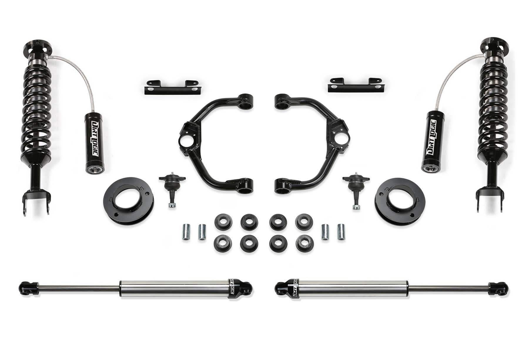

BDS / Fox released their 2020 suspension but its only a 1" over stock for rebels
Those FOX 2.5” coil overs with adjustable resis look legit... but wow, $2100 for the set and only 1” lift over stock ORP!

I’m looking forward to to testing my Fox out tomorrow with the factory control arms.
What was the part number on those? Last I looked, I didn’t see a Fox w resi Kit... but it’s been a few months now. Looks like it’ll be a nice setup!
Thanks, the part is 833-06-166 for the 2-3in and 833-06-165 for the 2in.
Did you take measurements? Looks like you got a fair amount of lift in the front.
I’m at 39in with the factory UCA and 2in setting.
