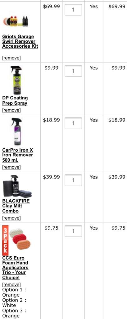

I jumped in head first this weekend and researched this a ton. Decided if I’m going to do it, I’m going the DIY route. I have loaded up a cart at Auto Geek and ready to hit submit. I’m basically starting from scratch (pun intended). Feel free to correct my list if you see errors or omissions. For anyone else interested, you get 20% off at Auto Geek, and if you submit your email they send you a separate code for $25 off. You can use the $25 off the polisher, and 20% off everything else. I’ve decided on the following:

Looks like that will increase my total spend to about $320 to get my feet wet.
I’ll take the plunge and post some results to another thread when I’m done. Just need to find a weekend that offers 10hrs of free time...

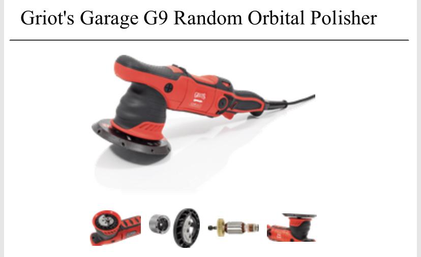

The Griots G9 is the best orbital on the market with a lifetime warranty. I have both a G9 and a G8 for tight spots. Even with $320 into this, it is still far cheaper than paying someone $1500-$2500 to do it for you and you'll probably do a better job anywayThanks guys, I really appreciate it.

That's a good setup. I have a cheap $70 amazon 6" DA and I use a pad attachment kit for my cordless drill similar to this. The drill works very good for fender flares, mirror caps and some of the bumper sections. I will need to get a Griots DA once my amazon one craps out.The Griots G9 is the best orbital on the market with a lifetime warranty. I have both a G9 and a G8 for tight spots. Even with $320 into this, it is still far cheaper than paying someone $1500-$2500 to do it for you and you'll probably do a better job anyway![]()
That's a solid kit. The RA polisher will last you a lifetime. Since this is your first time I am going to throw in a few pointers, maybe some other members can join in with what I miss, if you already know all this maybe it will help the next person.Thanks guys, I really appreciate it.

Great advice my friend!That's a solid kit. The RA polisher will last you a lifetime. Since this is your first time I am going to throw in a few pointers, maybe some other members can join in with what I miss, if you already know all this maybe it will help the next person.
Grab some cheap microfiber towels off amazon for removing the ceramic. They don't have to be 400 gsm plush ones. Fold two of them in half twice so you are working with 1/4 of the towel. Use the first one to get 90% off follow up with the second then flip for the second section. Then fold the other way for the next spot etc. Do not keep using the same spot on the towel throughout the sections where you do your application. When you're done throw them away. The ceramic will dry on the towels then you are scratching the surface you spent so much time polishing, that's why the cheapo towels and the ceramic will not come out in the washing machine. I usually look for one color, I have one color for interior one color for wheels, etc.
Be really careful not to contaminate your polishing pads. If your polisher falls over hits the ground throw that pad away!
If you want to save the pad when you are done because you think it has more life left in it, put it in a gallon Ziploc bag with the same bottle of polish you used on the pad. Then next time you know what pad goes with what polish.
That Iron X is gonna stink. I think it's sulfuric acid. When you are done put that in a gallon Ziploc bag as well or you will get whiffs of it walking through the garage.
Be liberal with the spray when using a clay mitt. My experience is sometimes the mitt material can transfer to the vehicle and it is like tar to get off. You want enough solution to allow that mitt to glide. If you run out of solution any soapy car wash without wax will work.
I am not familiar with DP prep spray I usually use Dawn to wash off any wax, then a final pass with straight rubbing alcohol on one of those cheapo microfibers the last thing before applying the coating.
Don't be in a hurry, enjoy the process, work in small areas at a time, you will achieve professional results.
