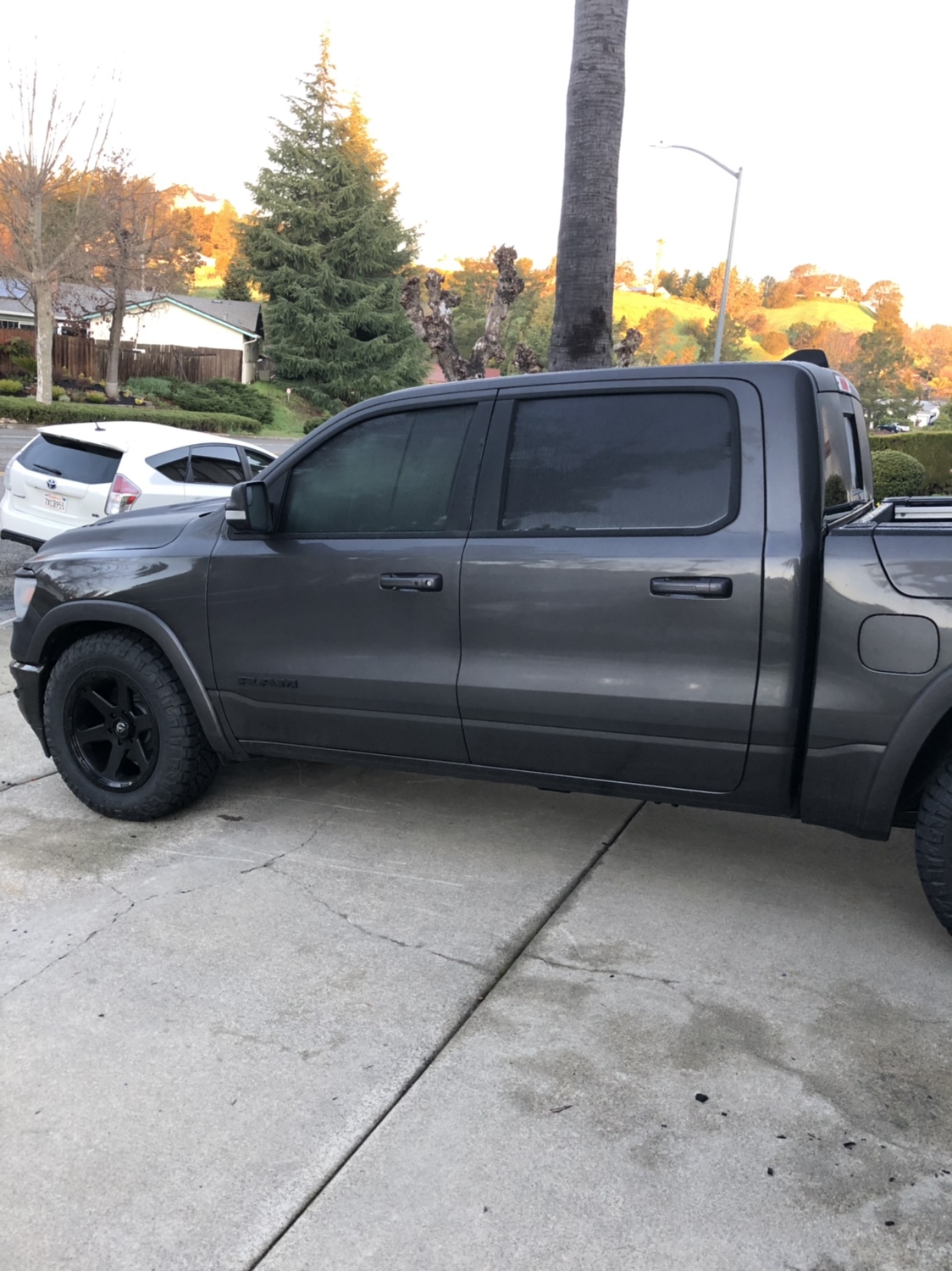

Went through this battle... here you go.
285/65R20 will fit stock air suspension but tight. I downgraded to 275/65R20 and they run nice. I do have the off road group but my riding partners all run 275/65R20 on air ride 19 1500.
Bay Area, California- 2019 RAM 1500 Laramie Crew 4x4, 5'7 Bed, Granite Chrystal, E locker, Black Interior, 5.7 Hemi, 3.92 axle, Level 2 Equip Group, 12in NAV, Advanced Safety Group, Pano Sun Roof, Bed Utility Group, Air suspension, Off Road Group, 20X9 +1 Fuel wheels, 275/65R20 Nitto Ridge Grapplers, Deployable bed step, 33 gallon tank, Ram Box, Trailer break control, Mopar Slush Mats.
What mode is the suspension in for this photo?
