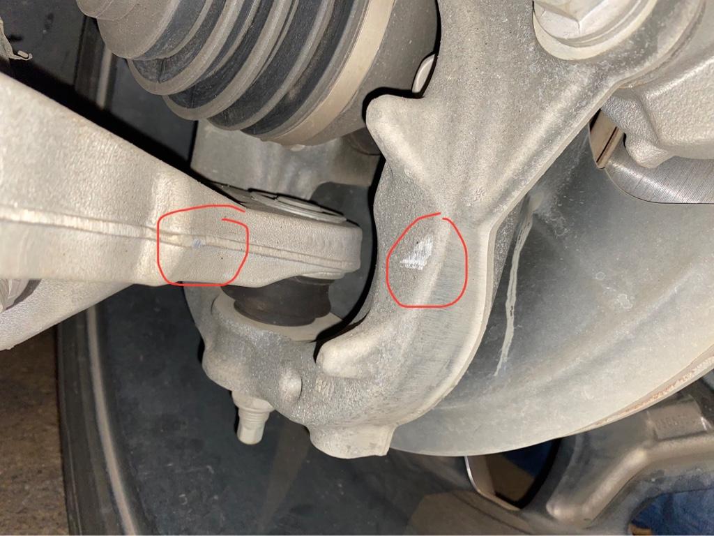

Mine just started to do the same. 2020 ram 1500 limited at 23k miles. Could it possibly be the knuckle stopper? Noticed that they is grinding indication there and they are metal to metal contact.
