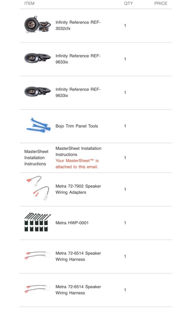

After many weeks of perusing all of these threads and trying to make any sense of what to do or which direction to go had me very confused and unsure. I took the most recommended set of speakers and installed them. The infinity reference 9633ix 6x9s in all 4 doors and infinity reference 3032cfx 3 and 1/2s in the dash. What a pain in the ***. But also very worth it. The truck sounds a thousand times better. Way more than I expected and I’m very satisfied with the difference. Highly, highly recommend.

Hey jmbennington, did you notice any drop off in your bass with the Infinity 6x9's? My truck is the 2023 model that has the blue cone 6x9 speakers. They produce really good bass both front and rear. This is coming from a guy who has upgraded every single car audio system in vehicles I have owned (including my wife's) with subwoofers, amps, speakers, etc., so I have a fairly well-trained ear for clarity, definition and of course the punch from subwoofers. This one actually sounds very good with just changing the dash speakers. The stock 6x9's have the ability to vibrate the rearview mirror slightly at higher volumes, but you still can feel the bass at lower volumes. Just curious if the bass was better, worse or the same after changing out the 6x9's?

The stock speakers I had were trash. There was hardly any bass. And it was horribly distorted if there was.
The infinity’s definitely deliver more bass.
My 2020 ram had a loudness button and those speakers sounded ok. This one (2022) does not. I’m unsure the difference other than that but it was enough to make me change the speakers. I couldn’t stand it. I hope that answers your question.

My system does have the loudness button. It helps. I'm glad to see the speaker change benefitted your system. Your answer gives me something to go on. Thank you for your reply.

No worries. It was kinda hard to filter through all the posts and figure out what applied to me and what didn’t do I just went with the simplest solution first. Good luck.
