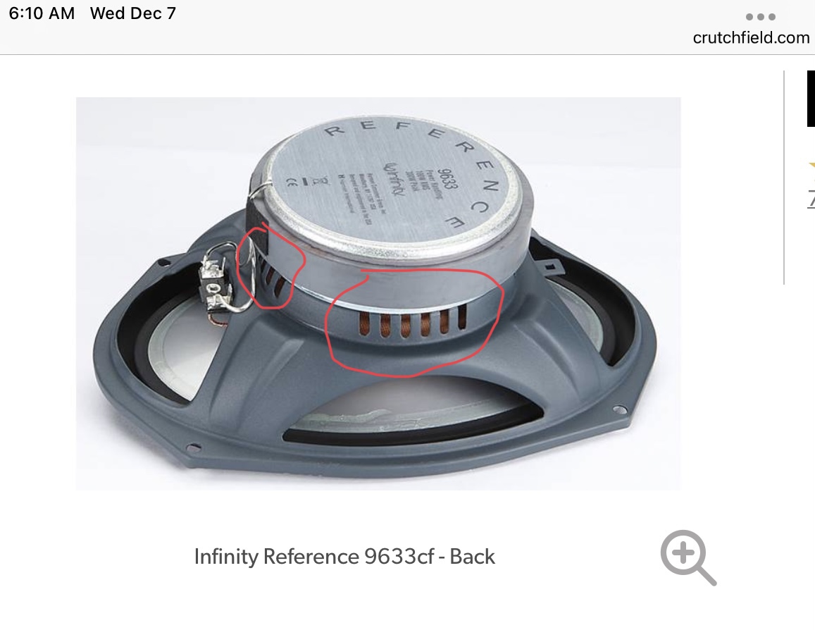

I’ve had the infinity references for 1.5-2 years, but both of them in the front doors are shot now from moisture getting to them any time I wash the truck or it rains. For the audio guys out there, is it more likely that the speakers themselves were affected by the moisture, or the crutchfield adapters? Obviously the stock speakers would’ve been affected by the same levels of moisture but I never noticed issues with the stock ones. Thanks!
I think the infinity’s are more likely to be damaged by water intrusion than the stocks, because of their design. The reference series (if not all Infinitys) have a vented voice coil, which allows water to get in the speaker. I dont remember if the stock speakers were vented, but I highly doubt it. you can get baffles to go around the back of the speaker to protect against this, but it may slightly muffle the sound
Thank you for that response! That makes a lot of sense. Are all aftermarket ones typically vented?
I can't say for certain.. I think most of the time, it's only on subs. I can say that the CDT's I have aren't vented - not sure about others
Alright that’s great to know. Seems like a ton of people go with CDT so I’ll go that route if the stock ones bug me too much. Thanks!
