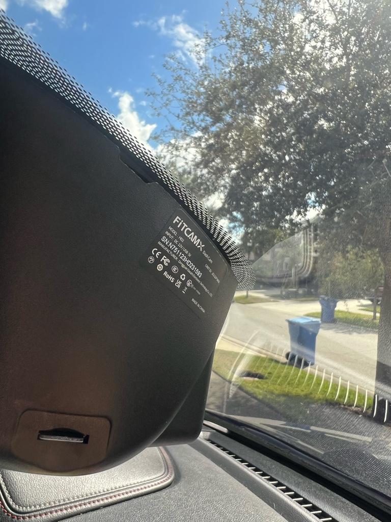

Just installed mine, 4k front and 1080 rear. Took about 20 min start to finish. Ran my rear cable along the bottom of the passenger side and had about 6” of extra cable that I tucked into the rear passenger seat belt trim.
Quality is good and app works better than the others I tried. Fit and finish is perfect and other than the Fitcam sticker on the side, it looks factory.
I didn't get the front rear, but mine has no sticker. I ordered as soon as it was available though, long before I ordered the truck.
