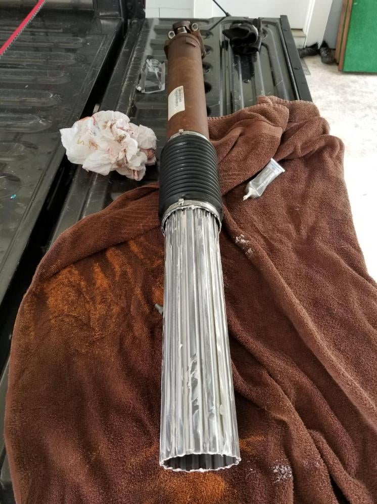

I have about 8k miles on my '20 Laramie with eTorque. Most of the time the start/stop is pretty seemless, but there are times when the truck lurches forward. I mostly feel this when I'm sitting in traffic and I release the brake to move forward a short distance. At times, it feels as if I will bump the vehicle in front of me. I usually turn it off in heavy traffic.
That may be in the driveshaft slip joint. I took mine apart and greased it with Schaffer red high tac grease and feel nothing now
I've heard of others doing this too, if you have any pics of the process I'd love to see them.

Set the E Brake and chock the tires then cut the two straps holding the black dust sleeve on the drive shaft, or just cut the rear clap off.
Unbolt the rear driveshaft flange from the diff pinion flange, 15MM socket then slide it out of the front section of the drive shaft. You do not need to remove the entire driveshaft, just the rear section of the rear 2 piece shaft.
driveshaft-1-jpg.84953
Pic isn't mine but essentially the same except I only unbolted the the driveshaft from the diff, removed the rear sleeve clamp. I greased the sh*t out of it with Schaeffer Ultra Red Supreme Grease, NLGI #2. https://www.amazon.com/gp/product/B00JF2L8GE/ref=ppx_yo_dt_b_search_asin_title?ie=UTF8&psc=1

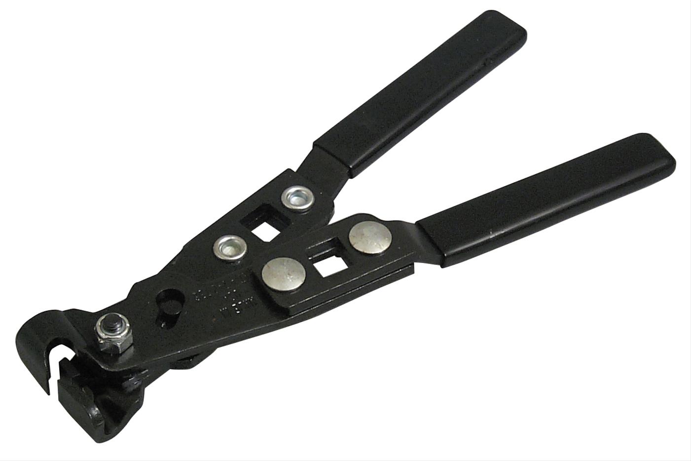

You will need CV joint pliers and clamps but some used worm clamps. I used this:
Amazon.com: Lisle 30800 CV Boot Clamp Pliers : Automotive
Buy Lisle 30800 CV Boot Clamp Pliers: Tool Sets - Amazon.com ✓ FREE DELIVERY possible on eligible purchases
www.amazon.com

Just make sure you phase the driveshaft correctly or you'll get a slight vibration on acceleration from a stop sign. To phase it, simply make sure the u-joint ears are all in line. Blue circles
