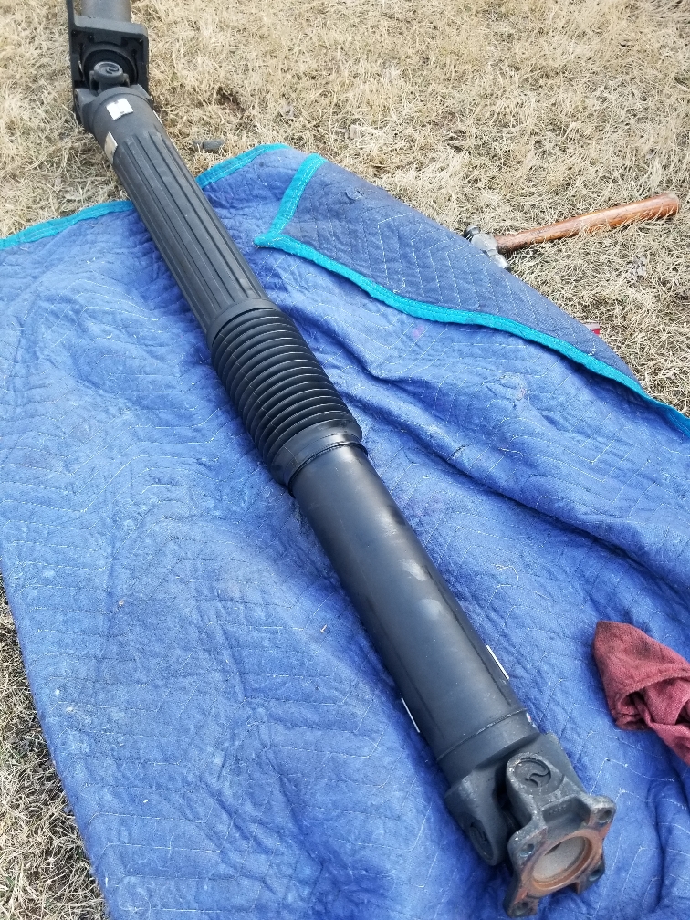

Guess what we took out this evening everyone? Gave up on the Stealership (useless) even thinking they could solve this mystery....well, my Son-in-law (Matt) is a Stud and we found the source of the clunk in my 2019 1500 Laramie with only 15k miles. Lack there of grease in this weird area of the drive shaft, hidden underneath that dust cover you see in the photo. Happy to explain in better details for anyone having these same symptoms on your new Ram trucks. Mystery solved.

Please explain more.

They need to remove the drive shaft, take one of the clamps off the dust cover closest to the rear. Slide the rear shaft out apply grease in the weird long extended slip yoke. Mine is smooth as butter now. I posted a pic earlier of the drive shaft and what the dust cover sleeve looks like.
