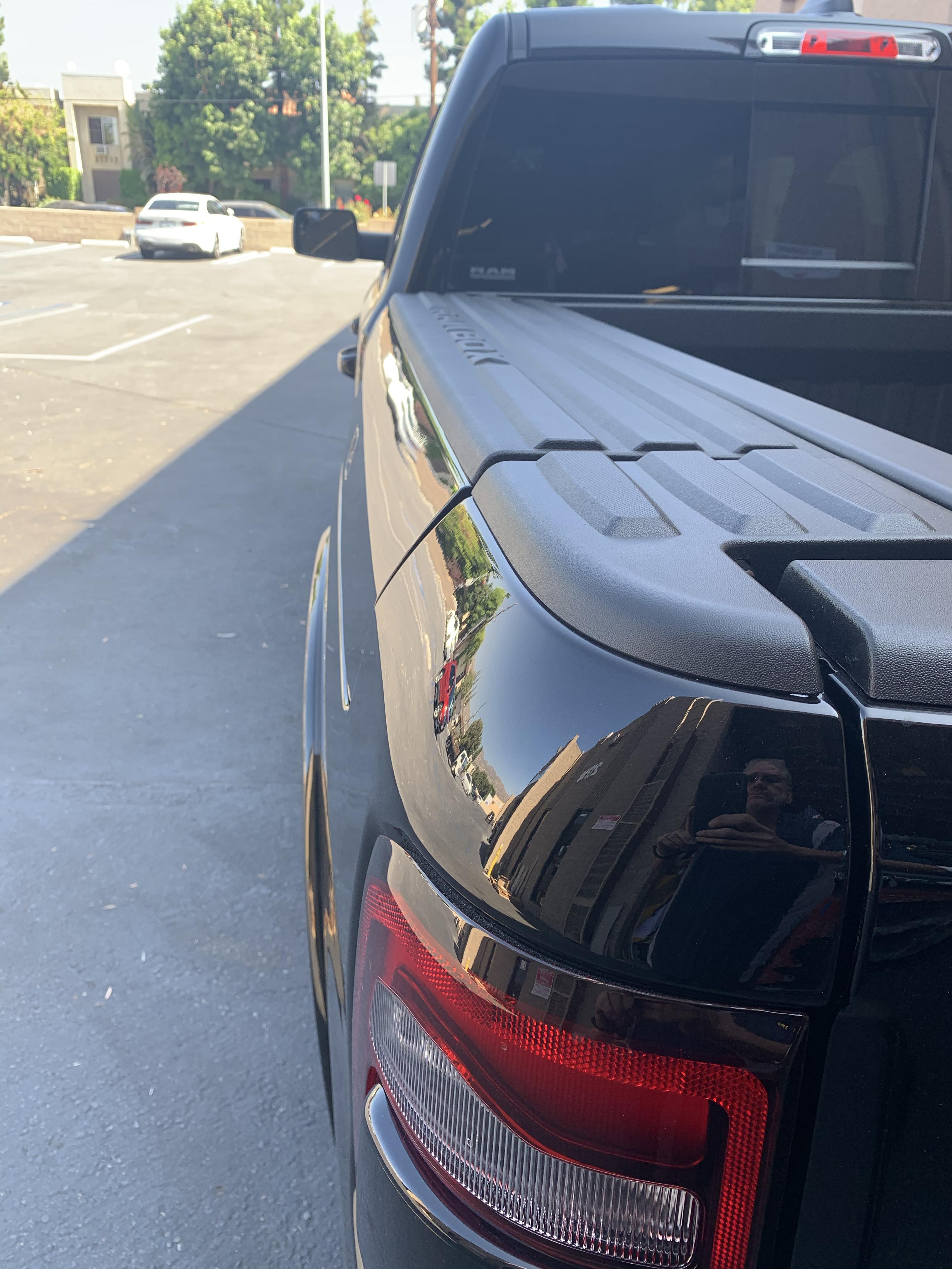

I adjusted my past 2 trucks using a large adjustable wrench. Really don’t need the toolHow much was the 'special tool' if you don't mind my asking...
How did you bend the metal loop?I adjusted my past 2 trucks using a large adjustable wrench. Really don’t need the tool
It takes a large adjustable wrench because the loop is pretty tough to bend.How did you bend the metal loop?

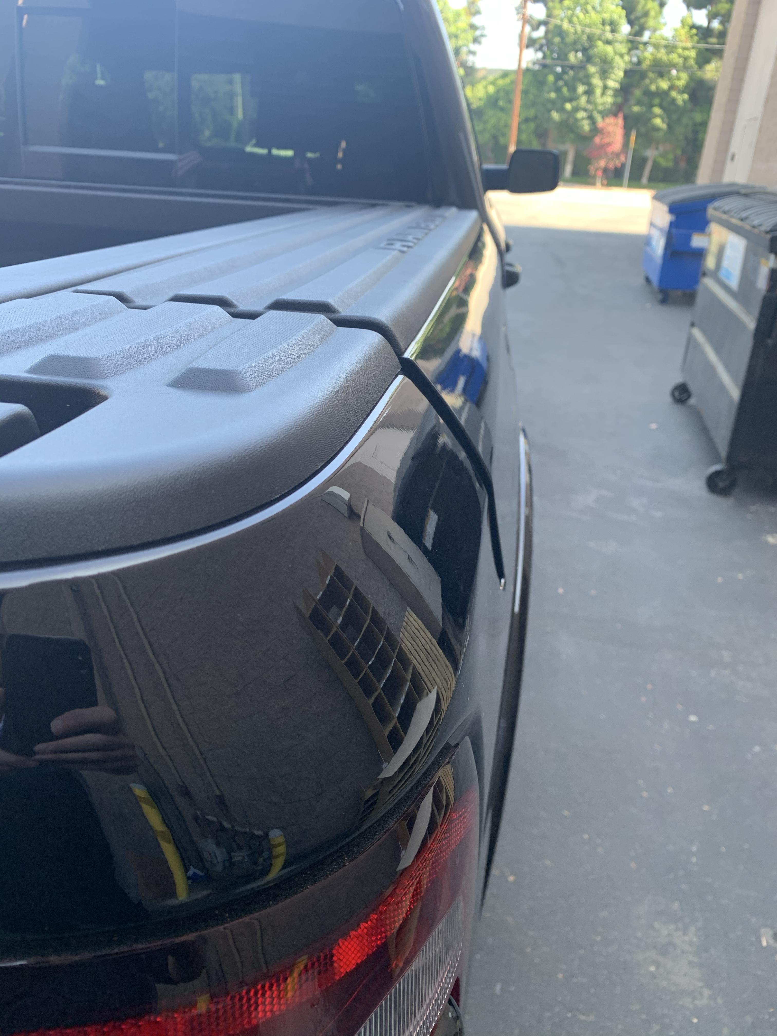

I'm trying to tighten my lids down to close the horizontal/bottom gap. I need the loop lower basically so the latch/lid has to come down more to catch.
Ok, I convinced..I'll give it a try this weekend! Can't find the tool (which is my preference) anywhere, so I'll try this. I did use large crescent wrench to get the side-by-side adjusted..might as well try this too!It takes a large adjustable wrench because the loop is pretty tough to bend.
Don’t have truck avail with ram box for pics. The pics will illustrate.
For bending down, work on top and bottom. Also, move wrench on left side and right side as needed, etc.
Same goes for left and right. Pics are reference on how to position wrench. Quite a bit of force at end of wrench. Note: bend loops in ram box, don’t remove and put in vise.
Takes a minute or 2 to figure out leverage, but works well.
I adjusted down, and side to side also. There is limited room on maneuvering wrench. I had to try wrench upright and upside down.Ok, I convinced..I'll give it a try this weekend! Can't find the tool (which is my preference) anywhere, so I'll try this. I did use large crescent wrench to get the side-by-side adjusted..might as well try this too!
Thanks![]()
I can see it'll be tight for the up/down adjustments for sure.I adjusted down, and side to side also. There is limited room on maneuvering wrench. I had to try wrench upright and upside down.
I can’t remember if I was able to work on bottom for moving down due to limited room. Maybe bending just top down worked.I can see it'll be tight for the up/down adjustments for sure.
That's what I'm try now..sketchy thoughI can’t remember if I was able to work on bottom for moving down due to limited room. Maybe bending just top down worked.
