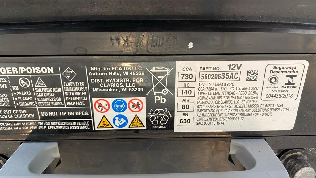

@RamCares 2021 Laramie hemi etorque built 7/21, with a battery date of 2/21. ~2,500 miles. 12” screen if that matters with the H/K stereo.
Did a couple hour drive on 10/16. Truck sat from 10/18 to 10/23, took a 2 mile trip, then sat until 10/27. Electronics came on, loud pop from the speakers like a fuse was blowing, several spark sounds under the hood. Tried it a few times, then everything went dead. Brought just the battery to Ziegler in Schaumburg. They ran a quick test, but said they couldn’t check it until it was charged. Then said I would need to have the truck towed in for them to investigate further. They wouldn’t arrange for a tow, I would have to call roadside assistance or another company they gave me. The attitude felt like they couldn’t have cared less that my new truck was dead already and didn’t offer to charge it for me.
I did get it charged at the local O’Reilly, but haven’t driven the truck yet. Electronics did come back on, but I didn’t start it since I wasn’t going to drive it right then.

if you look above you will see a pic of my battery and a volt meter.did you take a reading when its on "Load" 🤔 that why you can see if its the alternator.if you look above again you will see what my voltage reading while its "UnderLoad".we all here made sure when we upgraded that not only it would be a "AGM"but the next size bigger..H8.but we are following when you do (y) ;)
