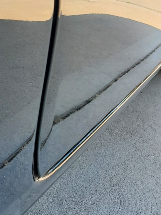

I told them they owe me a new door. Here's the damage.
Sent from my SM-G973U1 using Tapatalk
Wow thats bad. They cold just take a hammer can smack that corner back in
