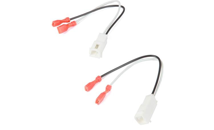

Thanks. Which adapter model did you go with? Any polarity issues?
Then ones Crutchfield included for free. You can’t mess that up. They are made so they can only go the right way polarity-wise.

Thanks. I know from other threads that there was a lot of controversy over the polarity and the two different metra adapters.
Thanks. Very impressed with Cruchfield, as they laid out everything needed for the install. Will def use them again for audio related purchases instead of Amazon.
