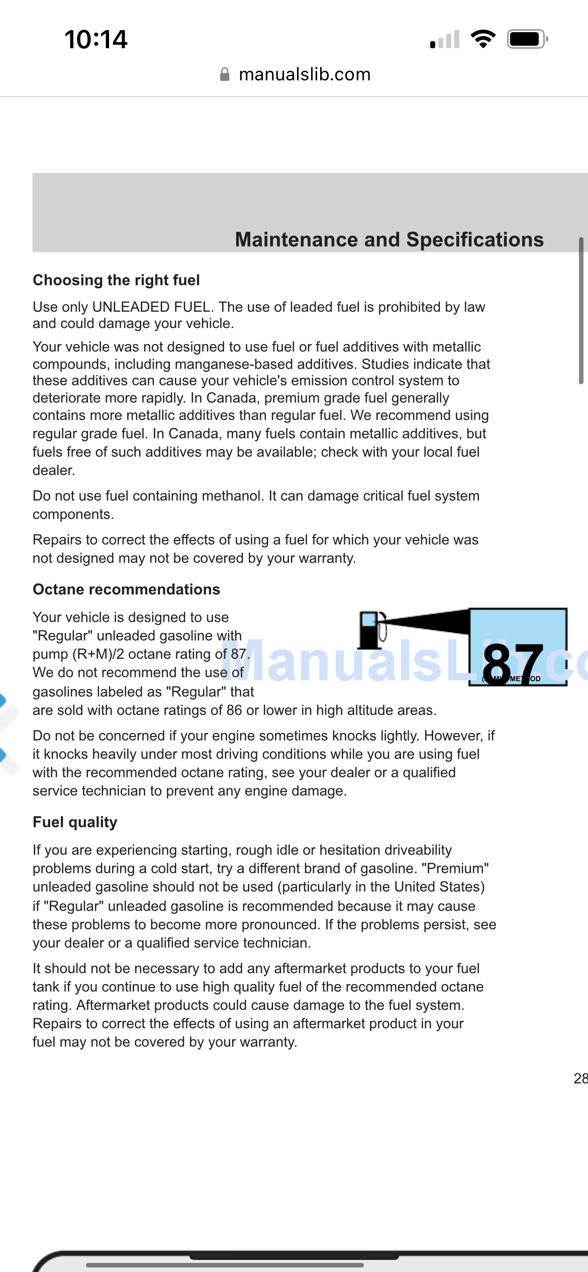

I got a full fill now on my 2004 Lincoln 4.6 V8 and it does not seem to like it. I noticed a lot of pinging. I will add back E10 each trip to keep topping up the tank and diluting it back to regular.
That said, the old Linc is not an advanced system so it may not compensate enough. I have yet to tell in the Ram.

Per the owners manual for that car it doesn’t mention even 10% e. So I’m sure the engine isn’t liking the 15%
My 2020 outback owners manual also says not to run 15%.
But our trucks say we can! Always worth reading.
Yea, don't know if they had e15 back then! I just gave it a shot. No harm.
