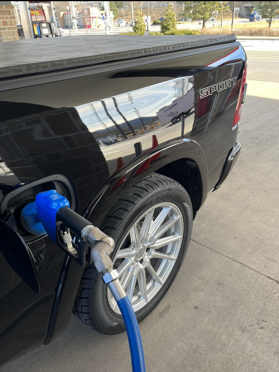

But I have been using the Unleaded 88, 88 OCT, E15, exclusively in my 392 HEMI for 2 years and the year before that when I could find it.
We camp every weekend. Road trip to events. Haul wood and tow vehicles quite often. My truck is a truck that does truck things. It never has the same fuel in it very long.
My fuel sensor level failed 60 some thousand miles ago...so I have to track my fuel usage by miles. I calculate every tank. It is absolutely a savings.
I will never buy 87 again. (Started using E15/88 in our Jeep too) It is 60 to 80 cents cheaper than 89 and performs exactly the same...the angle of my right foot bearing more than any other factor.
162000 miles on my ole 392 HEMI... These trucks love to work and drink fuel...might as well go with the cheapest alternative.
