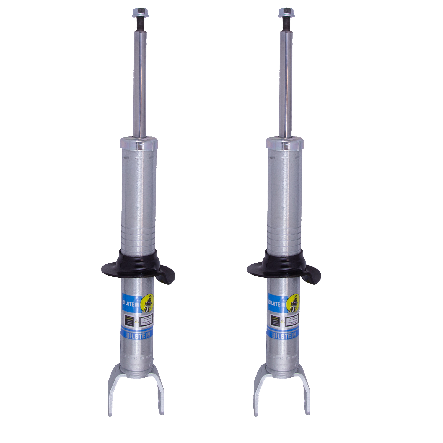

I've got a '19 Ram 1500 (no ORP) and I'm looking to lift 3.5". Currently my stock rake is 2 1/2". I would like to have slight rake if I were to pull a trailer. Would like to get the Bilstein 5100. What top hat would be best to pair to achieve the lift I want up front? What's a good UCA to get as well? What about the rear? Trying to get a better understanding of lifts/levels and suspension geometry.
get the readylift 2" level kit...it comes with the tubular uca's and the tophat spacer...I paired that with the bilstein 6112s on the 5th clip position and added icon 1.5" rear lift springs and bilstein 5100 rear shocks...looks level but there is about 1/2" to 5/8" rake...able to fit 295/55r22 toyo open country at3 and just had to slightly modify wheelwells to avoid rubbing

I contacted Bilstein to check and they claim the springs with the ORP will work fine for what I want(level it) part number 24-232203 and the setting to use on the 5100 would be #5 setting. I plan on just doing the fronts at this point since I only do normal household moving of things now a days and very little towing. Bad news is that my installer went from 2 weeks back order, to "late July" back order. Bilstein claims it's Covid related since their workers can only work so many hours with their reduced staffing. I was trying to get a better timeline on shipment or buy them direct but that didn't happen. They actually said their shipments to fill orders are kind of "the luck of the draw". Not good news but at least it's an answer. I contacted 4WP to see if they had them in stock, and was told by 1 person they did. I called back once I retrieved my CC but the next person said they were on back order.. sooo........
Would I be able to achieve the same with getting the 5100 for the front instead of the 6112?

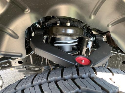

do you have any pics of the zone uca installed? haven't seen many of those.
5th clip setting with the readylift tophat spacer and their tubular upper control arms...got almost exactly 3.5"lift in the front and 1.5" for the rear
Is this what you ordered from ready lift?
yes sir
