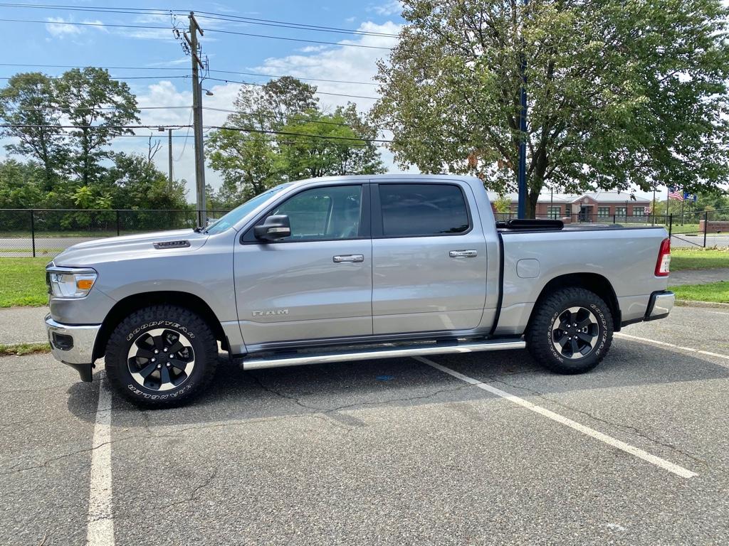

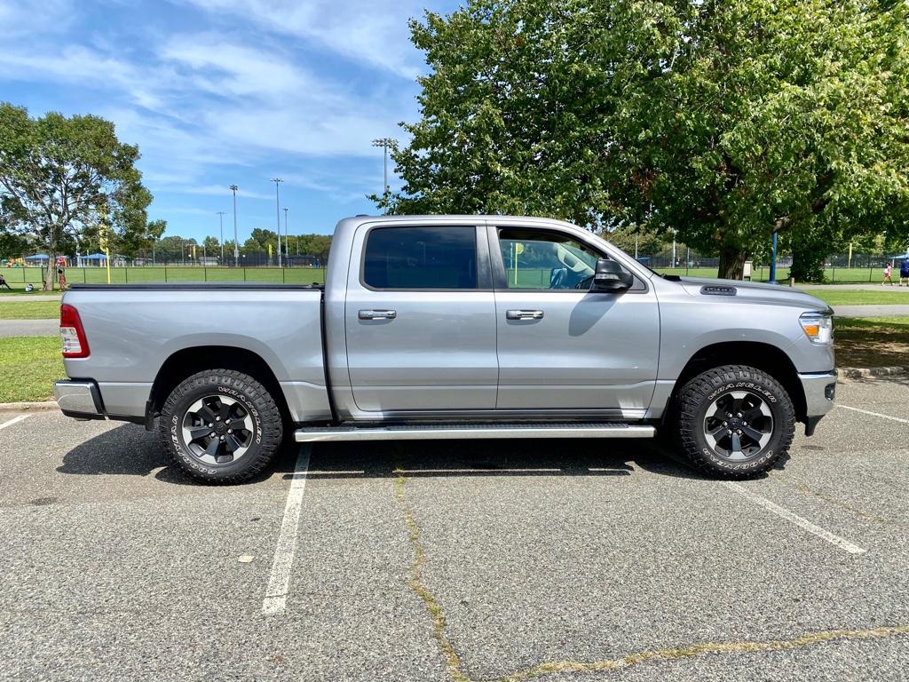

Have mine in the shop right now. Picking it up later. Non ORP, doing setting 5. I’ll post an updated pic when I pick it up

Got her back. #5 turned out to be exactly what I wanted. Ride is excellent. Firmer but not stiffer - if that makes sense. Corners excellent. Roll and squish is almost completely gone. I didn’t measure yet but i will when I get home later
Before and after
Did
Before and after
