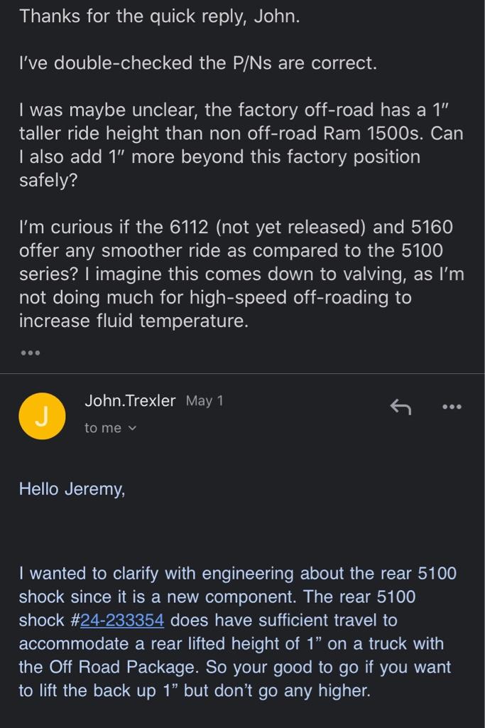

Thanks for your opinion on my bad advice... but I’m passing along actual information from Bilsteins engineering team from asking this question. Their website says the 5100 accommodates 1” of lift, but doesn’t specify if that’s from a stock non-ORP, or ORP, so I wrote to have them clarify. So this isn’t me screwing around, and you can see the email below for better clarity.
The 5100 will accommodate 1” extra lift along with ORP springs.
That means a non-ORP could accommodate 2” of lift with a 5100, since they designed it for 1” lift in addition to a stock ORP.
From that info, we can safely assume the 1.5” lift (from a non-ORP) with Icon rear spring is also sufficient.
I know this post is old, but I was confirming with Bilstein and a Major Canadian Bilstein supplier about the 5100s because I wanted to save $240, the cost difference of the 5100 to the 5160 rears. I don’t need the extra reservoir, that’s for off-road where you need heat displacing action. Anyhow I guess it all depends on you talk to because I got too different answers. Check out the 2 emails I attached from 2 different Bilstein Sources. Read what the Galileo person partially says about the ORP springs and measurements. This person knew what I was getting at and still really wouldn’t confirm it.
Also right now I am in the debate between ReadyLift 3.5 SST with Bilstein 5100 front and 5100 or 5160 Rears. I’m sure the 5100 would probably be fine considering ReadyLift doesn’t even suggest replacing the factory shock. I’m also in a debate with getting the Mopar 2” lift adding the ORP springs and then down the road I may or may not change to the RL (or RC) UCA, more then likely the RL one. Or maybe I order the Mopar and RL UCA now and then sell the Mopar one that comes with he kit, would people buy it?
Anyhow check out the emails.
Also, has anyone compared how level the ReadyLift 3.5 is compared to the Mopar 2” with ORP springs? I am in a debate, but I will know what I want if I know which one provides the better actual level. I don’t want any rake. Although I will probably be able to get the Mopar and ORP springs cheaper then the ReadyLift and Bilsteins. I can even add the ReadyLift UCA cheaper then what the ReadyLift/5100/5160 setup would cost.
Anyhow it’s not about money.... It’s about what gives the actual level look with no rake and the highest lift?
