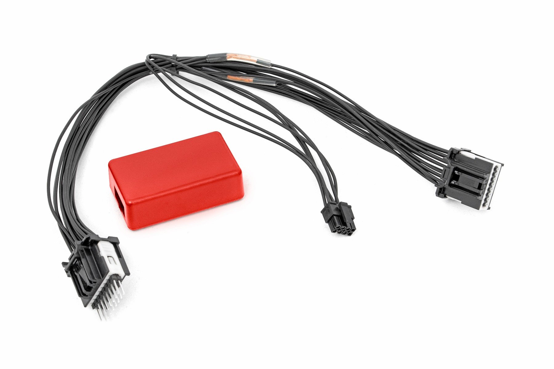

Ended up getting the Hypertech, mainly because I couldn't buy the Rough County online anywhere over the holidays. At any rate it was very simple to use, hardest part was plugging it in.

I would have laughed at him, then told him he should be embarrassed for his lack of product knowledge. You can show him the Rough Country calibrator or the AlfaOBD app, but I would just stay away from that dealership...they don't deserve your business.
