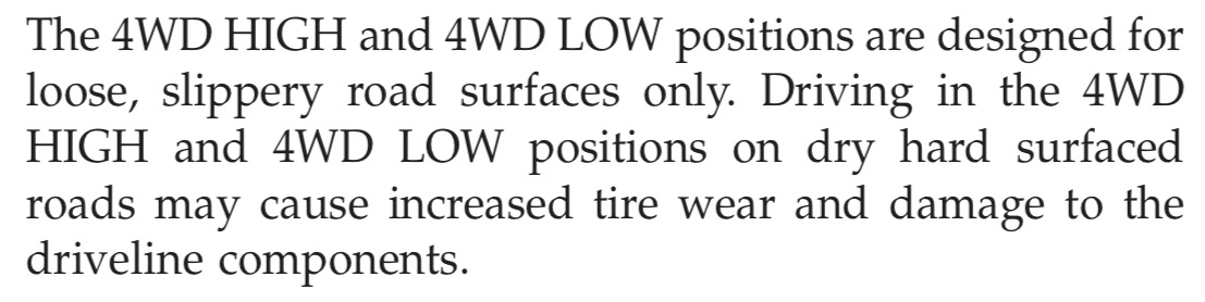

Put your truck in 4WD High and try to take a sharp turn.
Straight from the owners manual...

I've owned a dozen or more 4x4 trucks and every one of them binded up while turning on a dry surface while in 4HI and 4LO. Forward and reverse and sometimes worse in reverse.

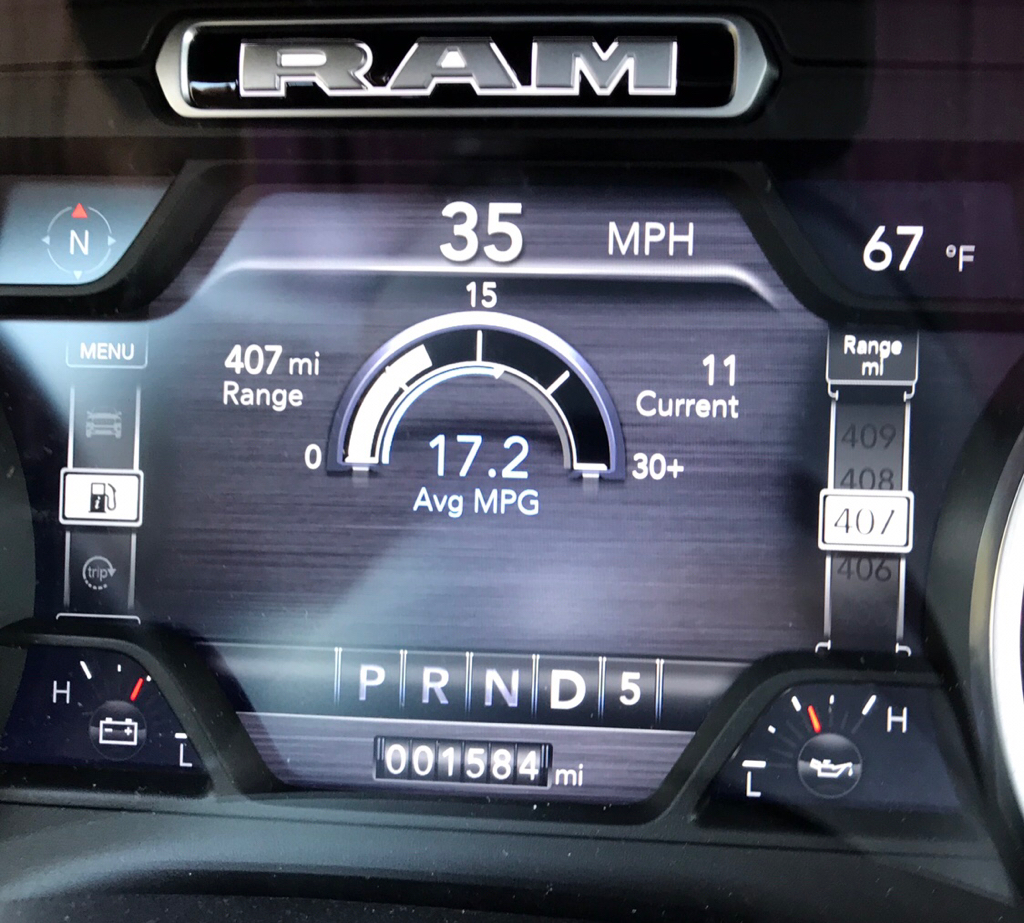

I just hit 5000 miles and mileage is getting better. Average 18.1 on this tank and that is mostly in town.

2nd fuel up. Fuelly says 15 mpg. My truck computer says 15.1 mpg. 75% city driving.
My city mileage is on par with my '15 Tundra, 13ish. Highway is significantly better than my Tundra ever did. If I can keep it under 85, my highway MPG is 19+.
