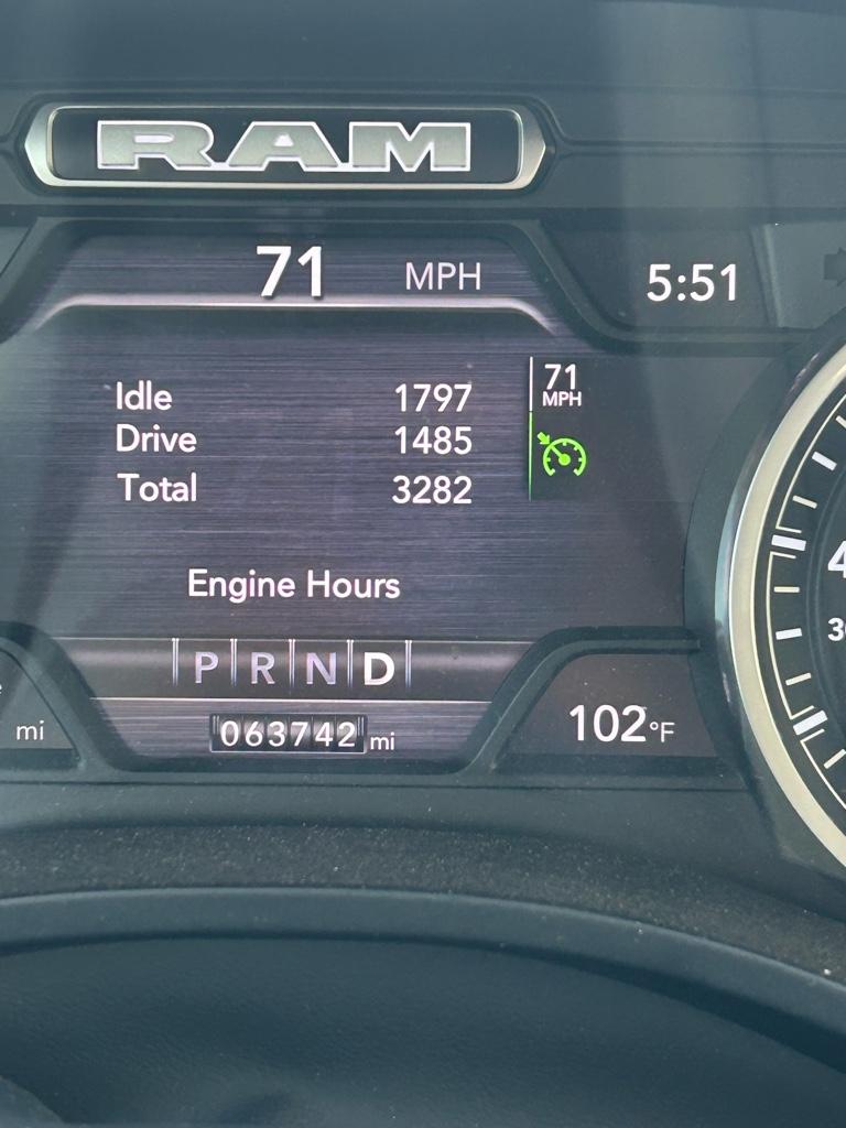

It's rumored that the Hemi had issues with idling causing the lifters to fail due to sufficient lubrication at idle. I would hope the Hurricane will be better

With the overhead cams, its going to be timing chain rails and chain wear. IMHO, lifter damage is due to racing engines RPM's then suddenly letting off the throttle. Full throttle then stops is bad for any engine regardless of make, type or construction. Passing another vehicle when "getting on it" should be a slow deceleration, not braking when at high RPM's.
That rumor has been debunked long ago
There are tons of cases where the hemi idles without lifter failure. That rumour is caused by youtuberz who don't understand the difference between correlation and causation.
Nobody will ever convince me that the ever changing oil specs on the 5.7 engine didn't have something to do with it. They made those engines for 21 years and only updated it once in 2009, but if you go through all the yearly manuals you see 3 or 4 different oil specs. CLEARLY this was for EPA certification and not engine longevity. First thing I did to mine was dump the 0W20 and go to 5W30 and all the ticking and valvetrain noise disappeared immediately. I probably could have gone 5W40 for summer use and it would have made the old fashioned 5.7 even happier.
