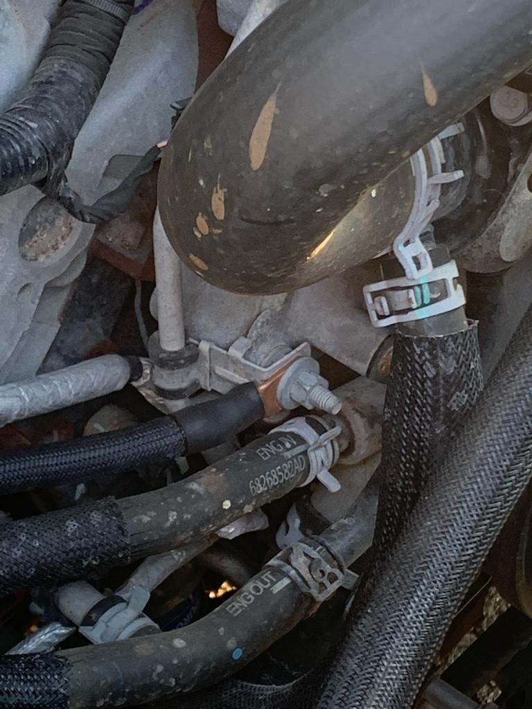

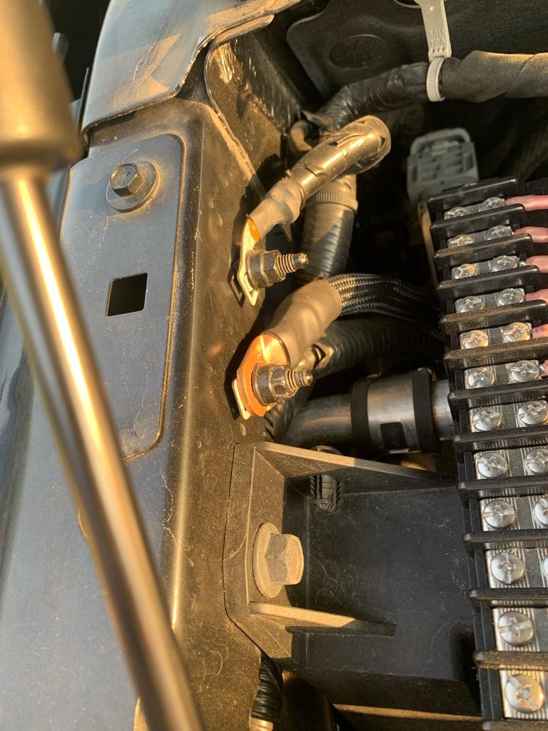

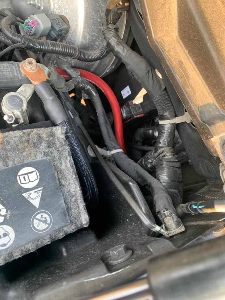

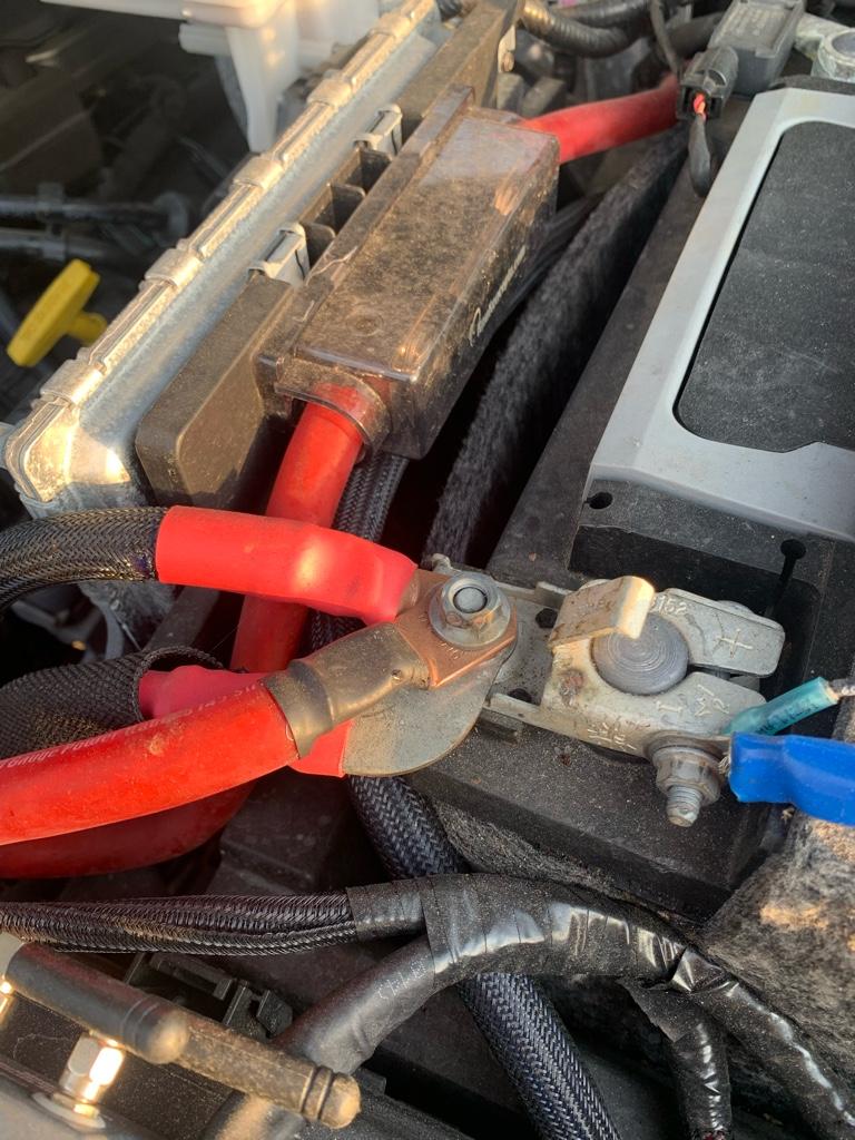

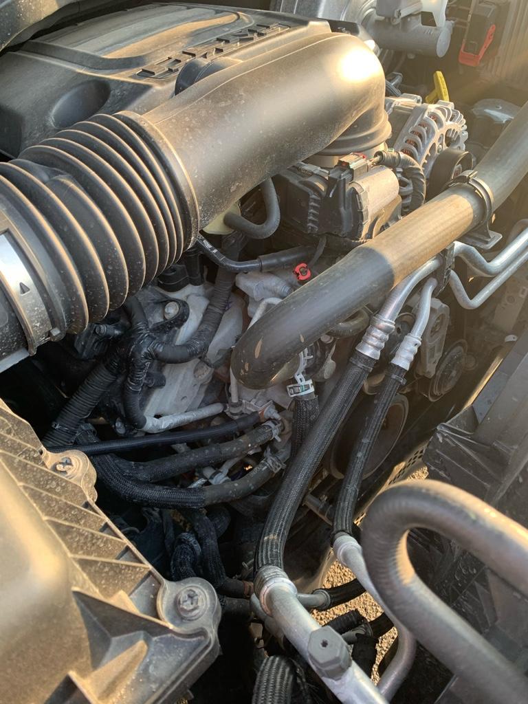

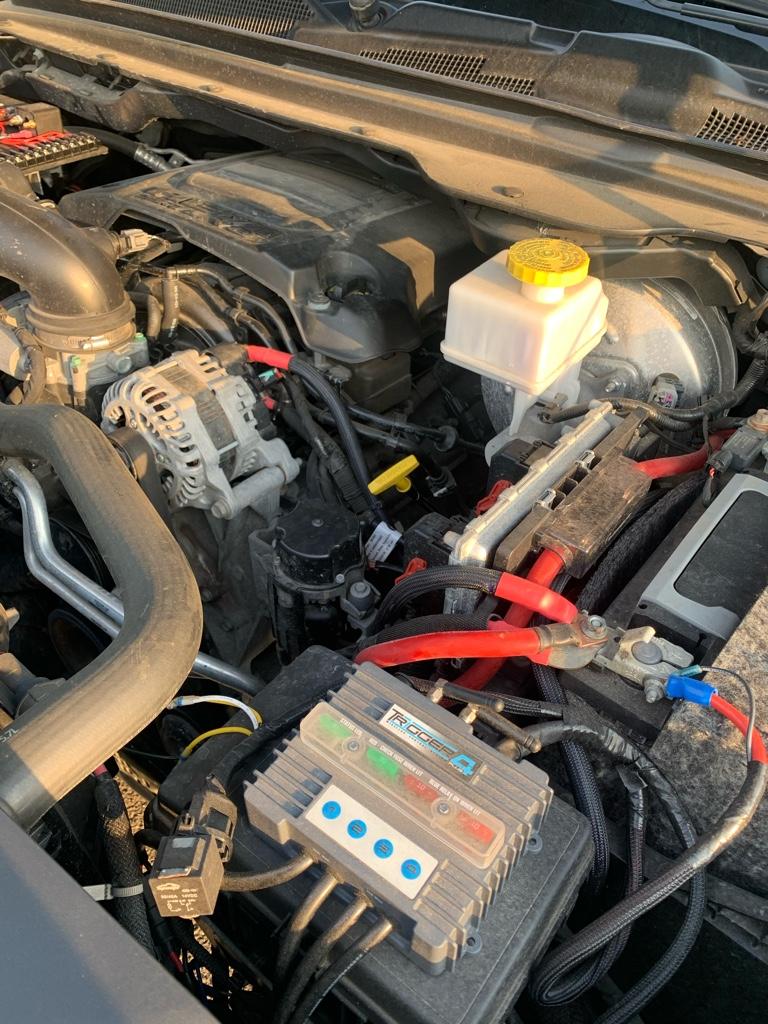

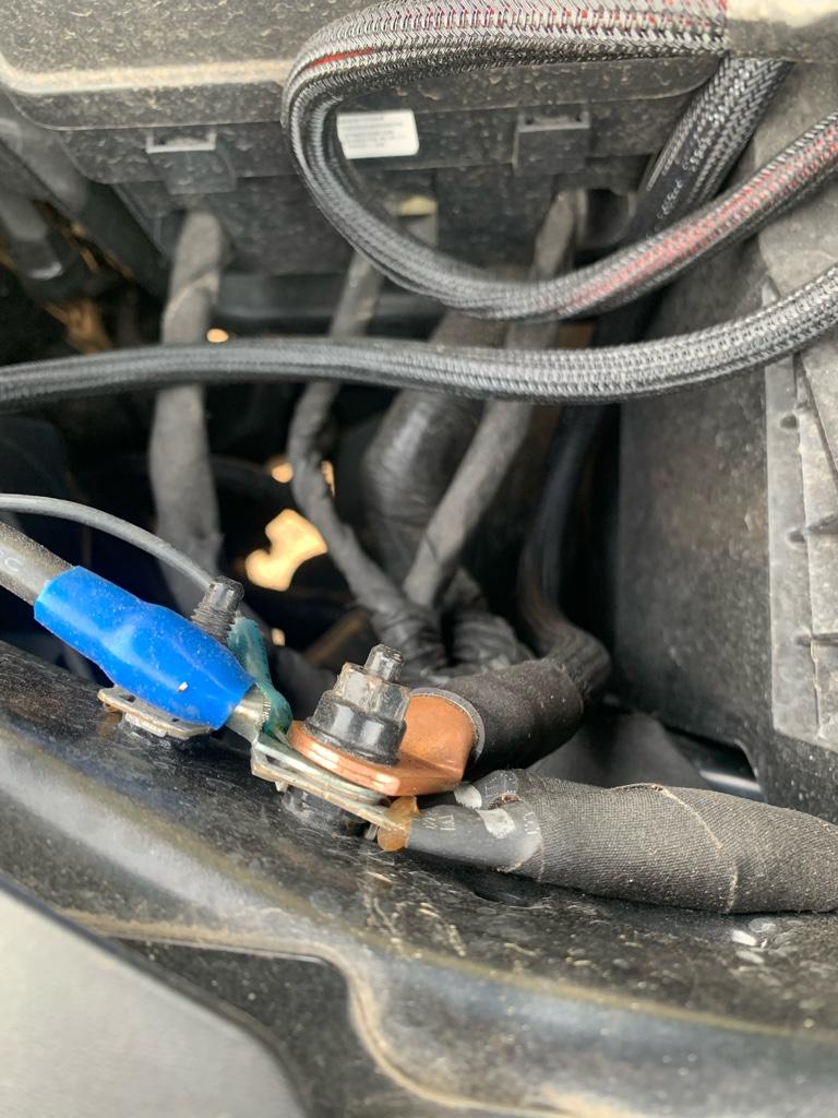

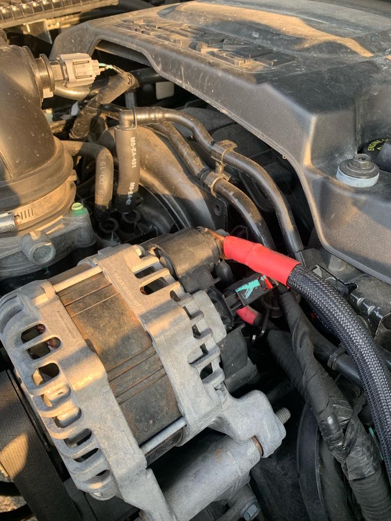

Pictures as promised.
So first wire runs from the back of the alternator to battery positive. Measure to fit, but it’s about 3’
Second wire runs from battery negative to frame. You can use the ground spot right there, but I ran it to a different one forwards because reasons. 1-3’
Third wire runs from engine block (alternator negative) to frame. I used a bolt on the front of the water pump since it was convenient. The alternator mounting bolt is also fine, but I already have a lot going on on that side of the engine bay and it was easier to hide it away on the left side. 4’
Make sure you leave enough slack for drip loops and zip tie the wires in place.
It helps to sand/wire wheel the contact points and then spray with corrosion inhibitor for extra connectivity.

I set mine up with the ground from the alternator bolt, and I fused my power wire for future upgrades. Currently with about 2400 watts rms and voltage from 13.8 - 14.3v. Plan is for a 300 amp h/o alternator and a D4S lithium battery to run about 4200 watts

IMHO while the fuse is certainly a good idea, it does increase resistance/voltage drop. And since the whole point of this upgrade is to decrease voltage drop, that kinda defeats the purpose of the Big 3 upgrade.
From what I’ve seen online people are split 50/50 on the fuse.
If you do wanna use a fuse, it should be as close as possible to the battery post (within 12”), and make sure the fuse (and wiring!) is rated for at least 20% over alternator output. I think our alternator maxes out at 180 amps, so use a 220 amp fuse, and appropriate wire.

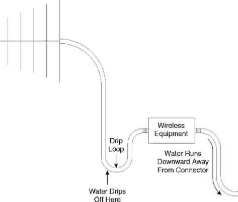

And I would highly recommend using drip loops on all wiring. Basically just allow the wire to droop between connections, which prevents water from running down the wire to the connection point.

I took out the fuse and re ran the alternator power wire. While driving, voltage goes up to 14.5v now. Also found a mounting location for the isolator relay, just need to buy the secondary battery.
