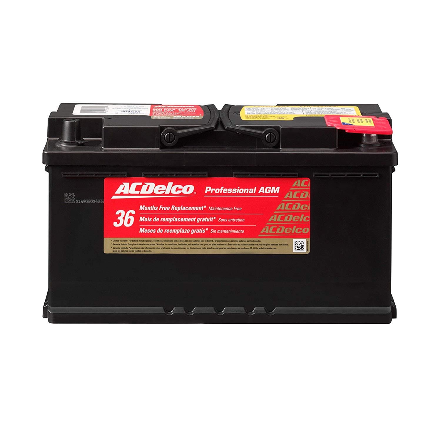

Nice think that's how I'm gonna run my big 3 wires in my 20 ram. Did you ever change your stock battery or get the d4s lithium? That's what I think I wanna do as well, change my stock battery to a xs power 4900 and put a d4s LTO 6.0 lithium in the back under my back seat. Prolly put an isolator inline jus ro be safe

I did upgrade the stock battery to that AC Delco agm battery. I down sized from a Taramps Bass 3K to a 1200 watt NVX amp, so I never got the LTO 6.0 battery. And yes they recommend to install with a battery isolator to separate from the agm battery.
